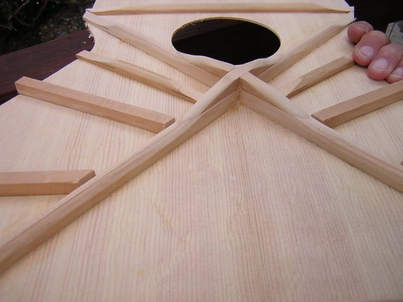

Hi. I've only built 4 acoustics, and was wondering why the little top braces, next the x brace, have a little space, and don't connect to the x. Is this so the top can vibrate? I'm referring to the Weissenborn style bracing, from the plans. Thanks, Alan.

Yes. Also the bridge plate, and little triangle piece at the x-brace. On the plan I have, it looks like there is a space of about 3/32".

Any one think this will help without hurting the tone? I did this because the last one I made caved in at the x brace junction, about an 1/8". Do you think I should carve them down some? the x is about 7/16" by3/8", and the cleats are about 5/16". Alan

I'm not an expert on Weissenborns but on my steel strings I butt the finger braces (and lower bout tone bars) up against the X brace and also drop a bit of Cyano glue in between end of brace and side of X brace to eliminate any chance of buzzing. IMO stopping the finger brace short of the X brace would affect rigidity of the top in the bout area but how much I couldnt tell you.

If things are just lightly in conntact there's the chance that they might buzz. you either want to make sure things are tight, or else that they don't touch at all. If you have a brace that ends before it reaches a liner or another brace, it should probably have the end carved away so that it's no taller than 1/3 the thickness of the top at that point, so that it will be flexible enough to move with the top and not peel up. Otherwise, it should be inletted if possible.

Are those monster-sized caps over the x-brace joint typical for a Weissenborn?
Everything I've ever learned about X-brace joints suggests that a thick cap (as opposed to a thin cap) adds only minimal strength but a fair amount of dampening. I'm far from an expert though, and I'm open to learning differently.

AStass, I agree with Kelby, your cap is really only needed in one direction and should only be about the thickness of the top of the guitar, say .110 inches. Longer is better, but an inch past the joint in both directions is fairly standard, so a 2 3/8 inch by .110 splice is all that's necessary.

Thanks for the input. The "monster" cap is not standard on the Weiss. The plan shows the x brace that would go on after the first one is glued thickened, about 3/16", for about 2 3/8", just like you said. Unfortunately I caught that detail too late, so I will shave them down, and hope for the best. Thanks again. Alan.

A violin bridge weighs, maybe, 2 grams. It's thin at the top and thicker at the bottom to act, in some degree, as an 'impedance matching transformer', helping the flow of energy from the strings to the top. It only has to be stiff enough in the crosswise direction that the string 'knows' how long it is. The cuttouts in the violin bridge act as 'tuning circuits' to filter out some string frequencies and enhance others. Even a small amount of mass at the top of the violin bridge makes a relatively large change in the way it works, and in the tone produced. In particular, it vastly increases the impedance mismatch, and hinders the energy flow.
The guitar bridge has to be rather heavy and solid by comparison to work well. Ity moves up and down with the top, and can 'feed back' a significant amount of energy to the strings at some frequencies if it moves too much. OTOH, if it doesn't move at all, there's no sound, so the weight and stiffness of the bridge are a compromise. Typically, a steel string bridge will weigh between 25-35 grams. Even the patch in the photo is probably less than 5 grams, and I'd guess much less. It's not very close to the bridge, and not adding significant mass to it. It's heavier than it needs to be, for sure, but I'd hazard a guess that you would not notice a large change in the tone of the guitar if you put it together like that, and then trimmed it down to more 'normal' size.

I have heard & read that Weiss. style guitars are prone to collapsing at the X brace & "north" of the soundhole.
I have only built one, & I changed the bracing quite a bit. I feel that the top braces are way too thick for optimum tone & not high enough for optimum strength.
My Weis is only a year old now, but so far the top is fine.
I used 5/16" X .650" X braces & reduced most of the rest to 14" or 5/16" wide. I also eliminated a couple of braces from the original plan. The upper transverse brace on my Weiss is built higher & a little thinner than the original to beef up that "problem" area.

Thanks guys. I'm going to shave that big ole thing down to an 1/8". I'm building another one concurrent with this, and it's koa. I was going to go with bracing as you recommended, Daniel, thanks for the extra push in that direction. Also, if anyone is still here, do you think I should put some arch in the back? I don't think they originally had that. Another thing I've been thinking about is, how much sound is lost with that guitar sitting on your lap, and stopping the back from vibrating? Alan.

Hey Bruce, hi. Thanks for your input. I guess what I should do is get a dvd on git building , because I just go by my instincts, and top bracing is very esoteric, and probably the most important facet of acoustic git building. I think the only way to really know what to do is to build a lot of guitars, and see what happens with each one. My original thought, when I came up with the monster-baby x-brace, was that the x can still be flexible where it's important, and more rigid where it's not so important. Alan.
