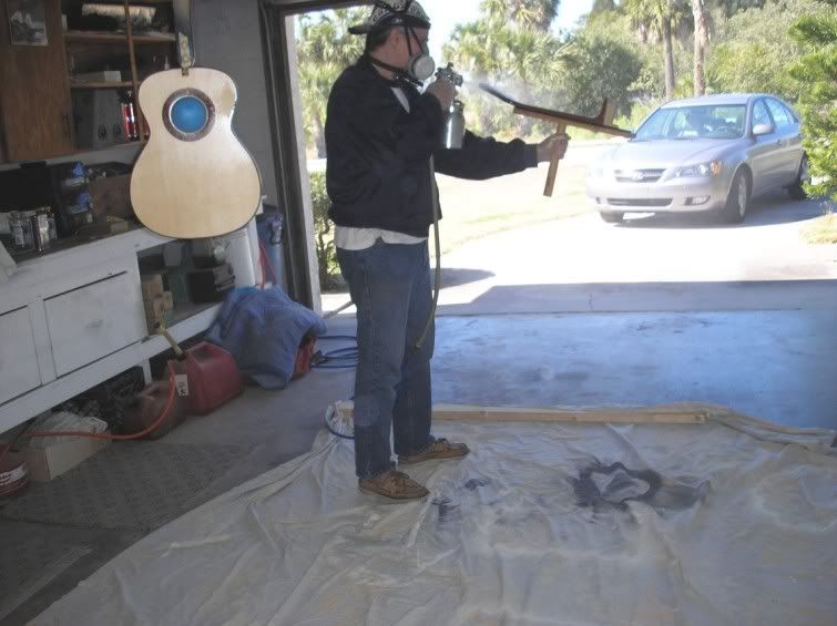

PostPosted: Fri Mar 09, 2007 1:11 am

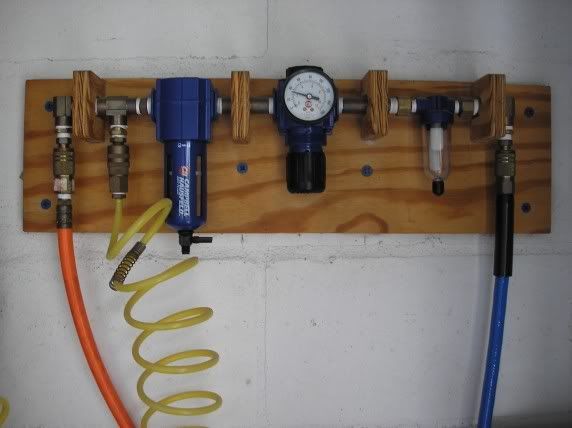

This is my regulator and moisture traps...
I think I have about 300 bucks in it all.
And see here, it actually works!
