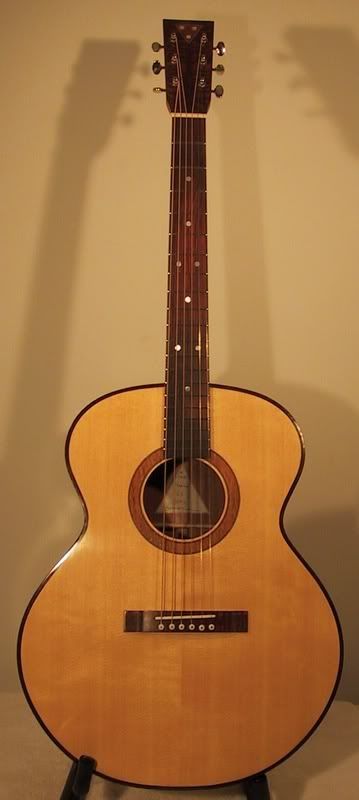

This is the 2nd in the batch of three that I recently completed. Specs follow:
Top...Lutz Spruce...Shane
B&S...Cuban Mahogany...Brad Goodman
Bindings, Bridge, Headplate...Snakewood...Zootman
Rosette...Honduras Mahogany
Neck...Laminated Honduras Mahogany w/ 2 CF rods
FB...BRW and bound with Snakewood
Liners...Woolson/Fox 2 piece solid liners
Glues...HHG on everything but FB to neck (epoxy)
Tuners...Waverly
Finish...French polish body; Danish Oil neck
A few firsts that I incorporated in this batch are worth mentioning.
...Untucked lower X-brace legs
...Woolson/Fox neck tenon jig. It works as advertised BTW and made the neck fitting a breeze.
...Woolson/Fox solid liners added significant stiffness to the sides.
I named the guitar "Mario" as a tribute to Mario Proulx. During my self-imposed apprenticeship over the past 4 years, Mario was the most important influence on lessons learned and techniques established. Thanks, Mario!
Check out the pics:
This is my first mahogany guitar...I love the way it works as well as how it finishes. The sound is very bright and crisp, with a loud and sustaining voice. It still sounds a bit tight and hopefully the bass will open up as it matures. I plan to use a lot more plain mahogany...thanks Colin!
The third guitar in the batch is in lacquer finishing and is about 3-4 weeks from completion.
Thanks for looking.

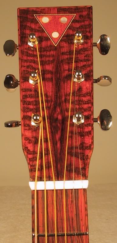

Another Beaut JJ!!...Maybe I missed it..but what's the story on your headstock design...very nice.!!

Irwin...Simple symbolism on the headstock inlay...the 3 dots represent my 3 sons.

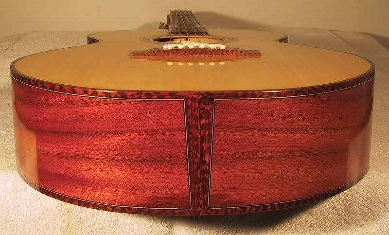

Yes indeed,Another beauty JJ! That Cuban mahogany looks great with the snakewood !I'm starting an SJ soon so I'll be asking you some questions.Is that snakewood binding that thick or is there a purfling on top? It's kind of hard to tell.

Dave...The top purfling is Snake-a-lam from the Zootman. I guess I should have done a pic to show it better.
