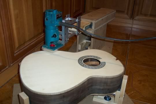

My only fear with that is the lack of foot print at the base. That looks to me like it could easily rock back and forth when cutting the channels. I would want to add two more mounting brackets to the base for sure. Make that puppy really ridgid.

[QUOTE=Rod True] My only fear with that is the lack of foot print at the base. That looks to me like it could easily rock back and forth when cutting the channels. I would want to add two more mounting brackets to the base for sure. Make that puppy really rigid.[/QUOTE] I was thinking the same thing. It might have a large plate on the bottom that would help a lot.

I agree guys,looks like it could use a little more support. It just seems like a smaller version of the Ribbecki jig.

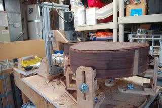

I had not seen this. I built something similar recently for my first guitar. It looks like we both have the 80/20 industrial tinker toy catalog. After seeing theirs, mine feels a bit overbuilt ... with it's wide base and full support, it does not rock or go out of alignment. Here's mine in action:
-PeterO

The Stew-Mac jig costs $215.00 conmpared to the LMI at $250.00
The LMI also includes a video instruction which makes the dollar difference too small to decide by price alone IMHO.

I, too, use the LMI style and find it works well, is very stable and uses a Porter Cable router with plenty of power. I did add one "extra"...a counterbalance to help offset the entire weight of the router/carriage assembly...sort of approaching neutral bouyancy.
Can't make out the router in the photo, but it appears to be a small unit...maybe some sort of "dremel" type...which IMHO would be underpowered. Also, as mentioned, the support footprint could stand some more beef to avoid "wobble" and the base could be wider for extra area to support the carriage unit at it's widest arc.
It is a nice looking rig and obviously well made. Maybe just a few fine tuning needs.

I think it is a a laminate edge trimmer of some sort Hank, plenty of power for the job.

thats looks like a Makita .. about the same as a PC 7310, 1/4 HP or so.

In addition to the small base it looks like derlin bearings to hold the router base.  How would these hold up for long term use???

Yes, the router is a Makita. Unusaul to see a router model available in the UK also available in the states. The machine is rated at 450 watts.

That's a lot of power. I have a cheap pawnshop makita laminate trimmer that might work but it looks underpowered to me. My other one is a Bosch, which I'm not thrilled with. It's definitely time for me to consider this kind of set up for bindings. Looks like you just set your guitar in that plywood base, with edges equidistant from it, and slide it around your stationary adjustable height router tower.
The rabbet guide attachment for my Bosch just about brought me to tears when it slipped during use on my latest guitar and I finally had to resort to using my monster Porter Cable 1/2 inch plunge router, along with some creative inlay artistry. I'm still a beginner and sometimes have to just use what I have. The guide for your Makita looks much better than Bosch's. Thanks for the thread.
