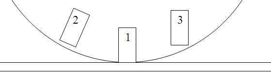

PostPosted: Wed Mar 14, 2007 5:07 am
Guys: A simple curve is the arc of a circle (with a single radius). This is what our dishes have.
A compound curve has more than one simple curve.
With respect to braces see this diagram:
The dish is shown in a sectional view with a small radius to illustrate the following:
Brace 1 is a brace at the center of the dish which may also be considered the guitar back in cross section along the long axis of the instrument. It has a simple radius corresponding to the simple radius of the dish. The brace is normal (right angles) to the dish surface and the flat reference below the dish. When glued to a back it will rise at a right angle to the back. This brace will tilt inwardly relative to a flat reference if used at the neck or tail end because the guitar back has an arc like that of the dish (see brace 2).
The brace at "2" is being formed or positioned nearer to the edge of the dish and at right angles to the dish surface but at an angle compared to the flat work surface under the dish. This brace will have a simple radius exactly like brace 1. It will also lie at right angles to the back and have a slight inward tilt if used at the neck or tail relative to the reference.
Brace 3 is being formed at the same location as brace 2 (off center) but at right angles to the reference surface NOT the dish surface. It will have a compound radius, not a simple one (1 curve along the width of the brace and 1 curve along the length). Thus, this brace will not tilt compared to the reference surface if used in the end positions of the guitar back because it has a compound radius built in corresponding to the arc of the back.
So, if you want your brace sides to be parallel to each other, in the height (Y) axis, you should create the radius by holding them at right angles to a flat reference, and at the position in the dish corresponding to their position on the back.
If you want each of the braces to rise from the back at right angles to the back itself, but not parallel to each other, you make your braces like 1 or 2.
Now, having said that, maybe it don't matter at all if they are parallel or not, I have no idea.

PostPosted: Wed Mar 14, 2007 5:57 am
Steve,
That's a great diagram that shows what I was trying to say - badly - in words. One point that a don't agree with though is that brace 3 does not have a compound radius on it's bottom. It has the same spherical surface as braces 1 and 2. All that is different between brace 2 and brace 3 is the angle in relation to the plane of the top of the brace is tilted rather than perpendicular. If you took brace 3 and put it where brace 1 is it will still fit the spherical surface but the top surface of the brace will be at a tilt. Another way to think of it is to take brace 1 and angle it to rhe right slightly (so that the top surface of the brace is no longer perpendicular to your flat surface) and sand the profile on the bottom. The bottom shape is the same as brace 1 and if you move this brace up to where brace 3 is in your diagram it becomes identical with brace 3.
A further way to think of it is to tilt your dish so that brace 3 moves to where brace 1 is in relation to the flat surface. This becomes the same as tilting brace 1 and sanding as I described above.
Compound radii surfaces come from shapes like cones not spheres - think of a compound radii fretboard.
PostPosted: Wed Mar 14, 2007 6:08 am
Dave - you are completely right - I stand corrected. Thanks for clearing that up!
