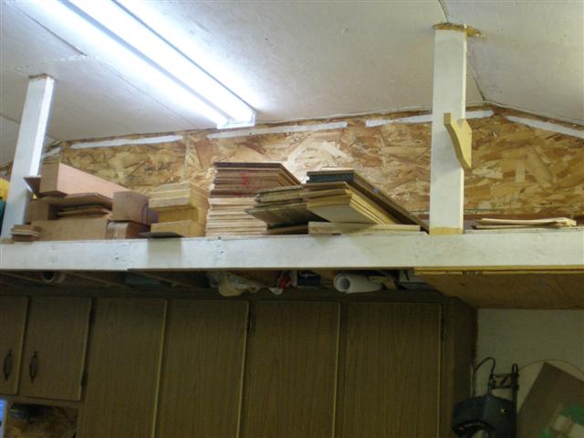

I'll second Pat's suggestion (actually I think I may have mentioned it in my first post) to make a built-in go-bar deck with some storage overtop.
Overhead storage is something I use a lot.
As you can see though, I need some better organization skills
