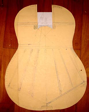

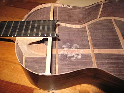

The attached pics show my first attempt at a top and bracing template, and the guitar (I am currently removing the old kerfing and cleaning up all glue residue on the RW). I am not sure if i should keep the upper bar in place. i could say it sits well there :) but its made out of generic spruce: not quartersawn, very coarse grain and lot of runout.

what you have started is a difficult project; it would probably have been easier to start from scratch.
but, first you will have to remove the fretboard, and remove the vestige of the old top under it. it will not be strucurally sound to proceed as you suggest.
removing the fretboard is a simple step compared to what you are already attempting. read up on it in the archives and if you have any questions, ask. before you do this pull the 1st and 11th frets, and drill a fine hole in the slot to take two locating pins, fine brads will do, so that you can get the fb glued back in the correct position.
as to your preconceived notions as to top thickness: the best thickness will depend on the stiffness of your wood, and the effects of your bracing. you may need to read up a bit on that as well, and come back with the questions the reading will provoke.

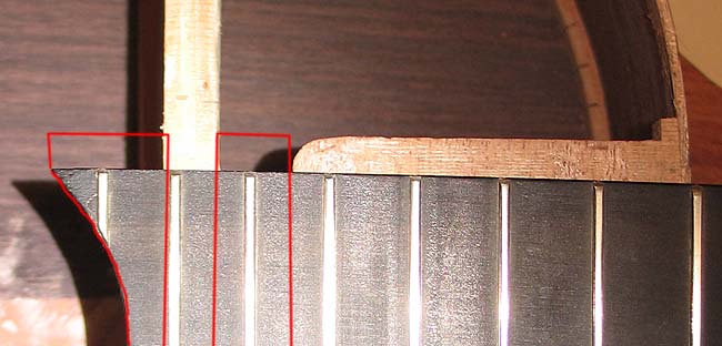

again.  When i opened up the guitar and found the wide heel I was quite
happy. As per pic, there is a wider than kerfing gluing area and I was
going to add two crossgrained spruce plates as per the red drawing.

this shouldn't be too bad a project. Rather than removing the entire
fretboard, just remove the fret at the body juncture (probably the 12th or
14th fret) and carefully cut through the slot with a small back saw. You
can now remove the remaining piece of top with the fretboard extension.
Then you can easily remove all the old top wood from the back of the
fretboard extension and reinstall it to the new top, once the new top is
glued in place. I'd also remove the old top brace. That way, all your
braces will be affixed to the new top before you glue it to the sides. This
method also allows you to tuck the ends of the binding neatly under the
fretboard. I have successfully replaced a number of tops this way. The
only other thing I did before I removed the old top was to make a quick,
open form traced from the guitar before I removed the top. When I was
ready to glue on the new top I would slide the form down over the sides
to hold them in shape. Good luck.

Id take the fretboard right off. I'd also consider a patch or a bit of bracing around the soundhole. The same goes for a patch under the bridge.
Removing a fretboard isn't that scary as long as you work to a plan and dont rush the job.
If youre going to dome the top then you'll have to work out a way of maintaining the correct arch while you fit braces. I work on a workboard which has been dished out in the lower bout area to about a 15" radius.
Good luck

I will certainly patch around the soundhole, just that I left it out of the drawing.  Not sure if I will bother to do it under the bridge. So far i read it depends on how stiff is the top across the grain (i guess i'll have to use my instinct and decide myself if it feels strong enough ) and that most people do not use it for spruce, only for cedar.
My top is Engelmann, AAA from LMI. They say they pick these for stiffness too, not just aesthetics.
What is the actual effect of doming? More stiffness, more volume? Is it changing the tone ?

Thanks Martin. I've also found an older topic where you show a pic of your radiused solera.  I'm off hunting for a some MDF or particle board to make a scalloped workbench.  I've measured a bit on my main guitar, an Alhambra, and it seems to be a bit less than 2mm at the edge. You mentioned "about 2mm" on your solera - that's about the same.  There is no scalloping in the bridge. I think I will make that to my bridge, profiling same as the workbench.  This should remove stress from the bridge-top joint and from the saddle. For example in my alhambra i cut the saddle straight but it only touches the center of the slot- there is a gap under the E strings. It goes away under full tension but anyway...
Your fan braces seem to be the wide and not tall type. Pattern is Tores? I assume that from the larger space at the bottom. The famous Segovia Hauser has a narrow endblock and the fan braces covering more bottom space.

Yes my Hauser's end block is a bit more robust than on the original and proximity of the end of the fan braces to the V braces is a bit different. Brace profiles though are fairly close to measurements taken from the original. My guitar isnt intended to be a faithful reproduction of Hauser's Segovia guitar...the intention is to incorporate as many of Hausers ideas as possible.
PostPosted: Fri Mar 23, 2007 9:48 pm
Posts: 1055
Fan and other braces are as per measurements contained in Courtnal's book "Making Master Guitars".
