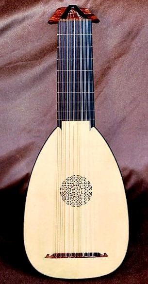

Based on a 64cm Lute of C1610 by Wendelio Venere. The front is Swiss Spruce (P. abies) from my stash. Very close grained and about 90 years old.

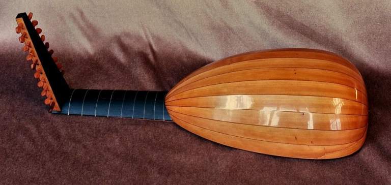

The back is in 13 ribs (I'm not supersticious) and is from the same 1000+ year old yew which blew down in a storm in 1987 and from which I made my other lute. Neck is stained sycamore and the fingerboard is veneered in ebony. Pegbox and bridge are in stained plum.

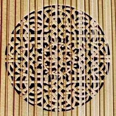

Rose design is traditional, and is based on a Celtic knot pattern. This is the bit Steve Kinnaird was waiting for!
Stringing is of course gut, as are the frets. Frets are knotted on after the strings are fitted. Re-fretting is a cinch!
Now all I've got to do is learn how to play the dang thing, I have heard it played and it sounds pretty good to my untrained ear.

Oh boy, that's really nice. With what are you supporting that tiny inner circle on the rose? (I don't see how you did that.) Do you have some bars running under it?

It's all solid Steve, all connected to the wood next to it, there are no supporting bars underneath at all. I shouldn't say so really but I'm very pleased with the rose, when I started it I wasn't sure if I had the ability to carry it off, but the answer seems to be go for it, but go for it slowly!

Yes, I did carve it myself directly into the top plate of the lute, very close grained spruce is required. It is a very nerve-racking task and took me months to do, as the steadiness of the hand and not breathing can only be done in short bursts.

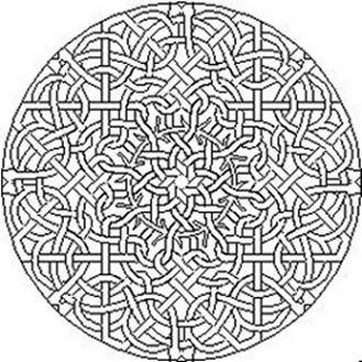

Start with the design, there are reference drawings for these at many of the museums, this is the reference drawing for the rose on this lute.
Transfer the drawing to the lute top I use the old system of pencil transfer backed up with pin marks through the paper onto the top at key points.
Initial perforations are made with a small hand drill to give a surface to carve. After that it's carved with surgical scalpels of different size very carefully, using them mostly as small scrapers. To round of the sections I use small scrapers with profiles to match the sections I'm carving. Checking with the original drawing very regularly is essential. Finish is with papers stuck to small shaped sticks.
It has to be done in a very careful regulated way you mustn't be in a hurry, never say "I'm going to have it finished by....". It does use up a lot of nervous energy as you are always thinking that one small slip of the scalpel, one sneeze, and the whole top could be ruined! It's the perfect job to do while glue is drying or sides are cooking. I wouldn't want to be building a lute without also having a couple of other projects on the go because it must never become a drudge or quality will go out the window.

Yes, it does have fan braces, three ladder braces, two above the sound hole one below, and seven fan braces. There are also six small reinforcements around the sound hole for support (Venere didn't do this but unsupported holes make me nervous)

Thanks Mattia, It has to be a labour of love the time it takes me! All together the rose took about 150 hours or so, I expect that with more practice it would be quicker. But I'm not in a race.

Yes I do use a mould to build up the back ribs. I know some people don't but I can't for the life of me understand why, it just like building a guitar without a mould, possible, but not so easy.
