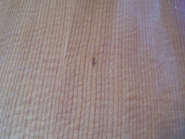

After I thickness sanded the top a small grey streak appeared.Almost as if there was a small weathered streak down in the wood a ways.It`s about 1mm wide and 5 mm`s long.Here`s a pic.Has anyone incountered this and what can be done if anything?

To clarify it`s the second small streak below the rosette to the right.About 1 1/4 inch down.It doesn`t show up much in the picture, but it`s real obvious.

PostPosted: Thu Mar 22, 2007 12:56 pm
Pitch pocket? It's hard to tell what is going on from the photo.

Yeah it`s hard to see in the photo.Not a good photographer.I guess it could be pitch.It just looks weathered.

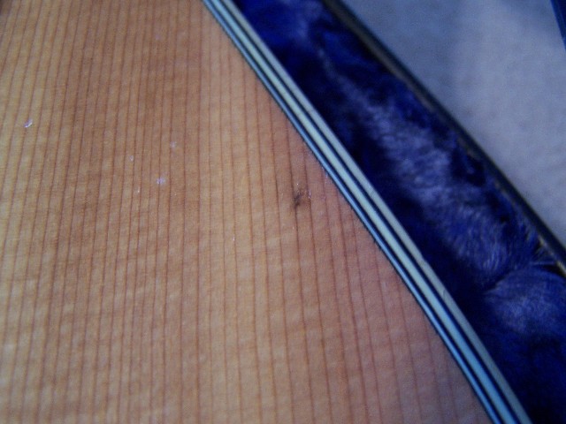

Maybe it will show up better in this pic.
                           James
James W Bolan
Nashville Tennessee
PostPosted: Thu Mar 22, 2007 2:20 pm
Ah, now I see it. Don't have a clue, James, sorry. BTW, don't forget to extract your undies from the sound hole. .

PostPosted: Thu Mar 22, 2007 3:09 pm
Posts: 1595
State: ON
James,
I have ran into this with Lutz as well (and all other top woods for that matter). I'm not exactly sure what it is but like Paul I believe that it is some kind of pitch pocket. As far as what can be done about it, I don't know of anything. I try to give the tops a good going over before I use them. If I notice anything like this than I will do my best to work around it. I have had the same problem as you were they appear on a top in progress. In this case if it is not to noticeable I will let it go. But if it is big and dark (I have had some really dark spots) then once or twice I have started on another top.
The bad thing is that as you sand more the spot may become more visible. It depends on how deep it is. Sometime you can sand them out, but I wouldn't try that on a top that is in progress.
This spot won't be covered up by the bridge will it?

PostPosted: Thu Mar 22, 2007 3:41 pm
Posts: 1392
First name: James
Last Name: Bolan
City: Nashville
State: Tennessee
The spot won`t be covered by the bridge,and it is a beautiful top.Almost perfect,except one little grey spot.

Yes,It does look to be under the strings so I wouldn't worry too much about it James.Unless you want to start a new top or maybe inlay something in that area to hide it.

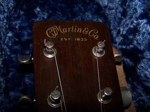

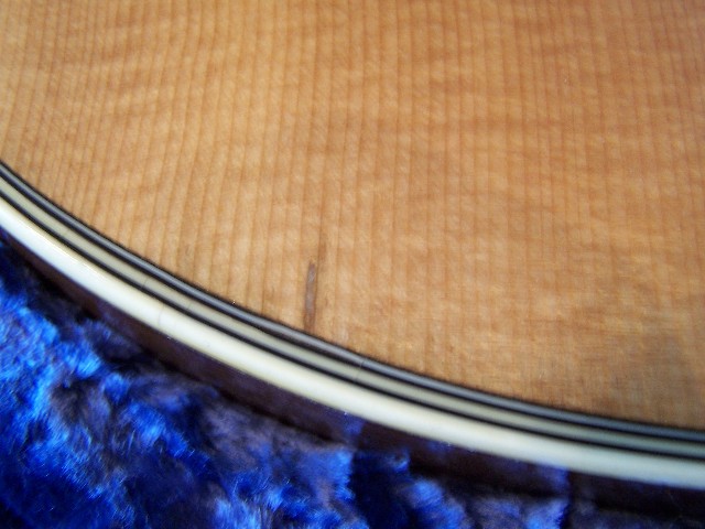

PostPosted: Fri Mar 23, 2007 10:58 am
Posts: 195
I know my opinion as a non-luthier (or merely an aspiring luthier) isn't worth too much on this issue, but I'm sticking to my guns on this one. There's nothing wrong with that top. Look at one of my guitars:
Here's another spot on the same top:
And yet another on the same top:
Say what you will about the three spots on the same top, but it's one of the three greatest sounding instruments I've ever heard and it was good enough for this label to go on it back in 1950, when it still meant unsurpassed quality...
The wood for our instruments was at one time alive, and like all living beings, it has flaws. What one man finds to be a "flaw", another finds "character."

PostPosted: Fri Mar 23, 2007 11:52 am
Posts: 409
James,
Have you cut out the top to rough shape? If not, you can probably find a matching graft on the trim excess. Line up a matching spot off the tops outline to match the grain lines width and use a small gouge to cut a graft/plug. Use the same gouge to cut the gray spot making a trench slightly smaller than the graft/plug. Glue with HHG and clamp, when dry overnite, sand execess graft/plug down ever with top. If done carefully these grafts can be nearly undetectable. Practice on scrap 1st.
