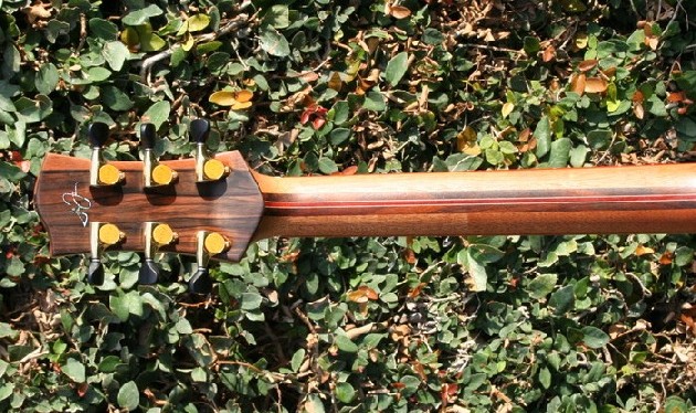

I am not even sure what it is called, but I really like the single or series
of stripes down the back of the neck. How exactly is this accomplished?
is it inlaid before the neck is shaped? If so, how deep would you have to
go to make sure you didn't sand through when making the neck its final
shape? Does this do anything to the integrity of the neck?
Peter - I hope you don't mind me using this pic. This one really caught
my eye though... very nice work.
Christian
Christian

I cant speak for the one you have pictured but most who build necks with an inlayed stripe do so by laminating the center strip all the way through the neck blank.
Besides looking nice it also is a good way to use a nice flatsawn board for a neck...take a flatsawn board about 6-8 inches wide, rip it in two and then stack the pieces so the grain in the wood goes in the mirror opposite of each other, whether that be face to face or back to back depending on how the grain was running on the flatsawn piece. Next plane or sand down the combination of woods you want to laminate to make the strip and glue the whole neck blank together. When it is shaped it will look similar to the one above.

Yeah, this looks like a 7 or 9 piece lamination. Looks great but the best thing is that the lamination makes for a very strong and stable neck, much more so than a one piece.

These are not inlayed strips of wood, they are full width pieces, glued up all as one big block. the cool thing as Shawn and Kim have mentioned is the added stiffnes it gives the neck.
The other cool thing is that when it's all glued up, you get two necks from one glue up.
Take a look at Charlie Hoffman's website, neck blank glue up for a detailed description of the process. Bruce Dickey also has this in detail on his site here.

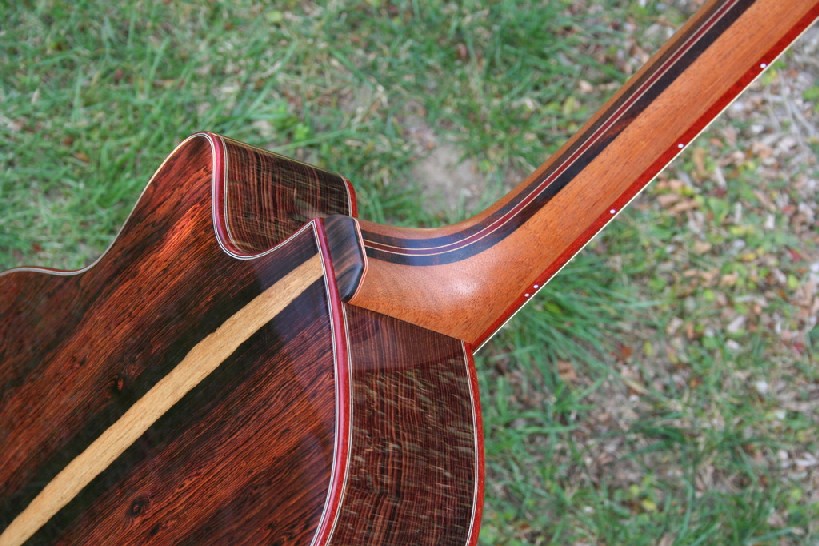

The other cool thing is that you really build the laminates anyway you like. John Watkins (back when he built guitars ) made some of the best laminated necks I've seen.
Here is one of his off his site CNCguitarparts (sponsor link above)
