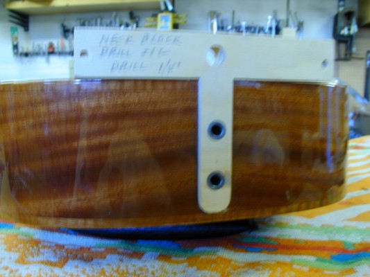

Here's a photo of the jig I use that fits right into the mortise and has two drill guide bushings to locate the holes the same every time. Excuse the fuzzy photo, but you get the idea.
Hank Mauel

[QUOTE=Daniel M] I like Hank's jig idea too, but you'd have to be really consistent in drilling the tenon for the barrel nuts. [/QUOTE]
I do it the reverse of your method...I clamp the assembled neck/fingerboard extension down (after the tenon is fine fitted) and use the centerpoint shafts from the inside of the box, through the holes, to mark the drill centers on the tenon.
