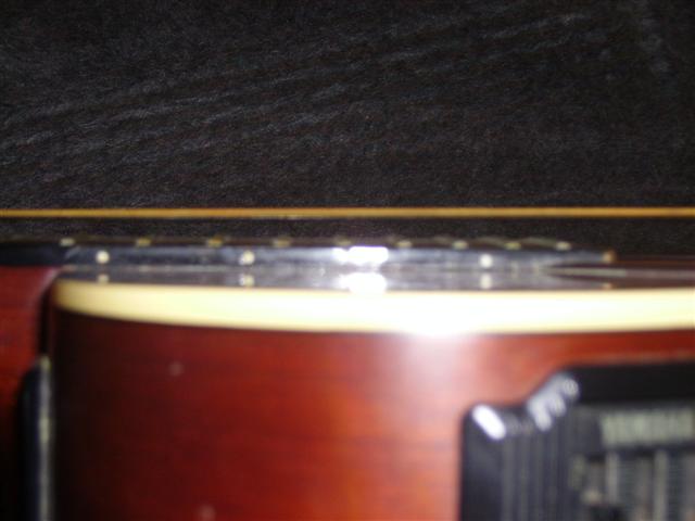

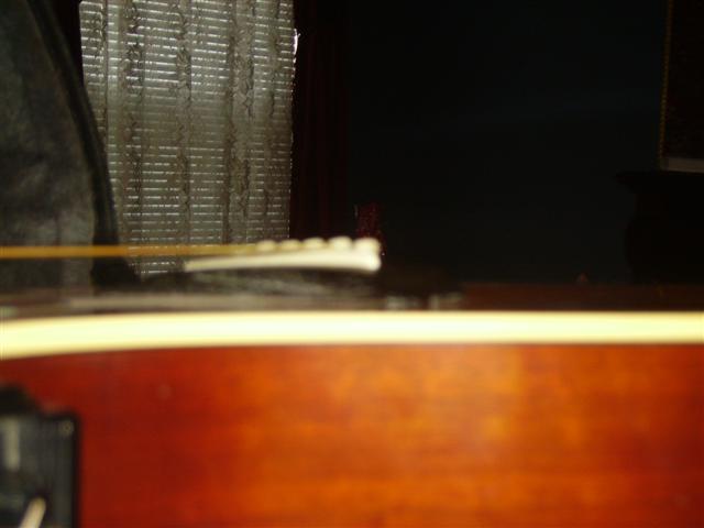

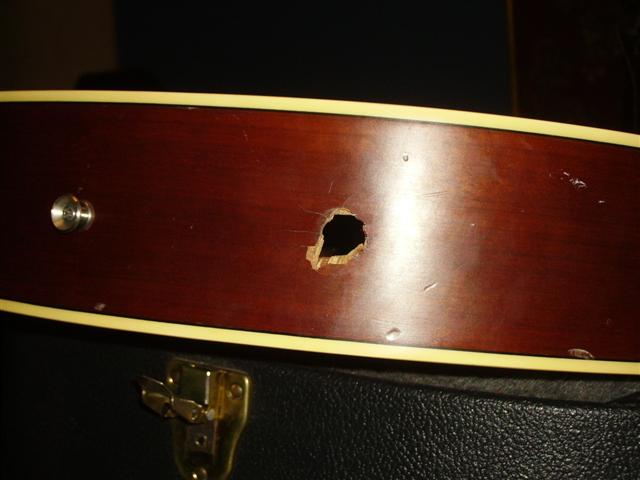

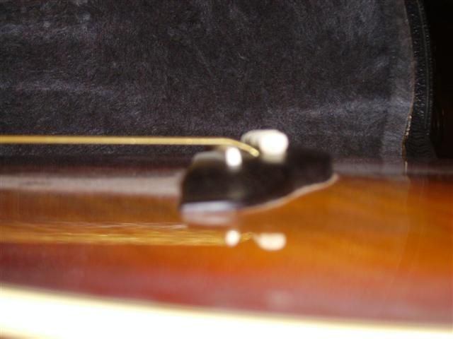

Hey guys and girls! This guitar belongs to our praise and worship leader...he's wanting to use it again after many years of non-use. The hole in the lower bout side is from the guitar being dropped while plugged in...I think I can deal with that one...my thoughts are to use a "Les Paul" type jack plate over the hole...now for the hard part (at least it seems to me)...the action is very high, the saddle is tilting a bit forward I think, and the top has pulled up (bridge "belly")...I'm thinking a neck re-set is in order, but does anyone out there know how Yamaha attached these necks? And do I leave the bridge bellied or is there a fix? Thanks for looking!

Those frets look mighty low too so maybe a re-fret would help first off. That is a lot of bellying (is that a word) for a guitar which can't be more than 15 years old especially for a factory guitar which generally gets overbuilt. Did your friend use medium string on it all the time?

Would this be a good canidate for that Bridge Dr contraption? Might be worth looking into it. Stew Mac sells it.

Hi Larry, check the bridge plate and see if it has buckled into a curved position. This happens alot on the imports.
Let me know. I usually shy away from those unless it is for sentimental value (like this one) and then I have to bust out the brain and start thinking.

I haven't pulled the neck on one of these but I would expect "stupid". As for the neck reset though try and visualize what the action would be like without the top rotation and arch that has developed. It may not need a reset.

Okay Evan, I think the bridge plate is buckled...I see what you mean about the geometry of the guitar if the bridge and top were where they belong...so, what to do now? I'm afraid I know what's coming...but tell me anyway...

Well option #1 is running around screaming. Option #2 is slightly less dignified. Questions: Is it one of the thinner body Yamaha models or is it a full body like a dreadnaught? Have you ever removed a bridge plate before? If it is the thinner body I will come over and we can start screaming together
