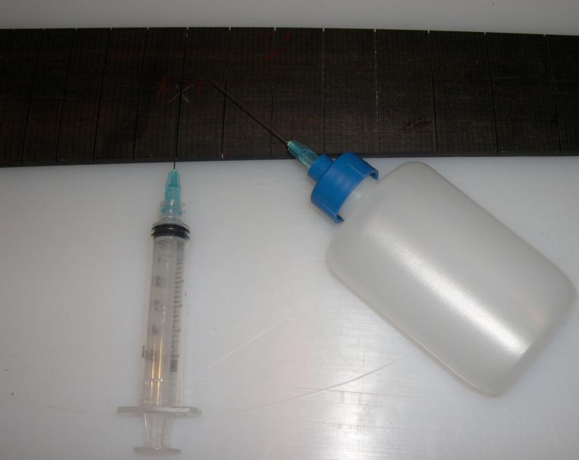

Here's the needle and other glue bottle they offer. The needle fits the fret slot easily and in the image is in the slot about 1-1/2 inches.
Warehoused Plastic Sales Inc

As a Doc, the 27g needle is very small. The pict above is light blue so it is
typically a 25g needle. I would think most drug stores would sell them
without the need for a prescription.

[QUOTE=azimmer1]As a Doc, the 27g needle is very small. The pict above is light blue so it is
typically a 25g needle. I would think most drug stores would sell them without the need for a prescription.
A doctor in the house...this forums got everything!
Yes I bought a 27 gauge syringe today (30 cents at the drug store) and it fits nicely. A 25 gauge would problably just barely fit.
