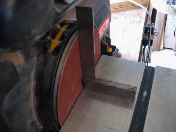

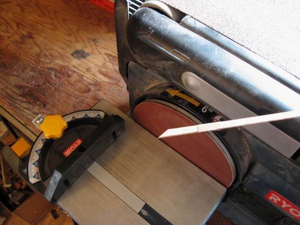

First, I check to make sure the table is set perfectly square to the wheel.

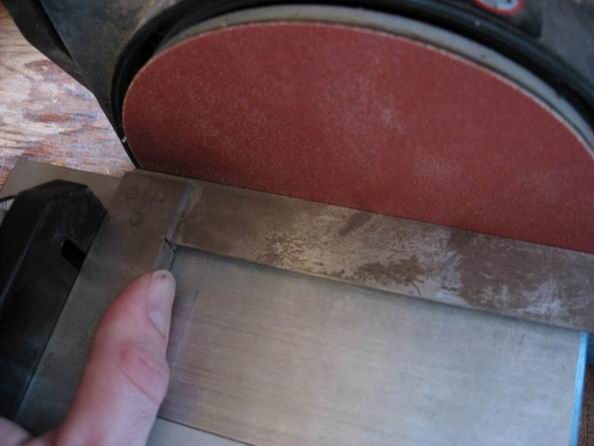

Next is the fence.

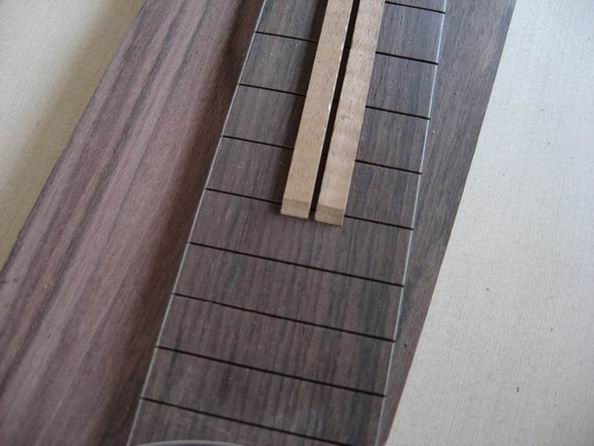

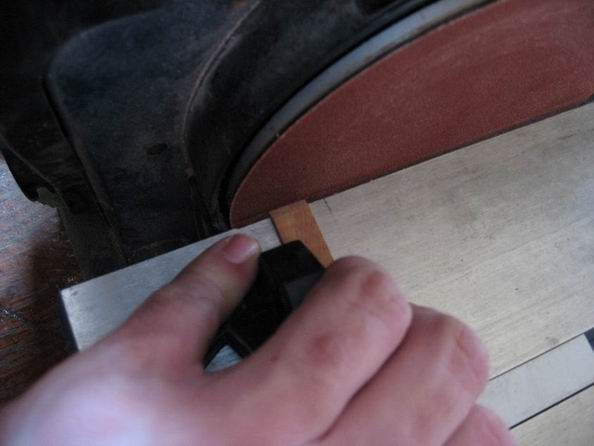

Then I tape the two pieces to be mitered together. For the angle, I pretty much just eyeball it. As long as the two pieces get the same angle, you should be o.k.
A little something I found very useful. When I'm done, I take the two pieces, set them side by side and WITHOUT turning on the power to the sander (I reapeat, the sander is OFF) using the fence, I very gently clean up the sharp point. We're talking minimal pressure and about 1 inch of travel...
The result. Two very clean miters.

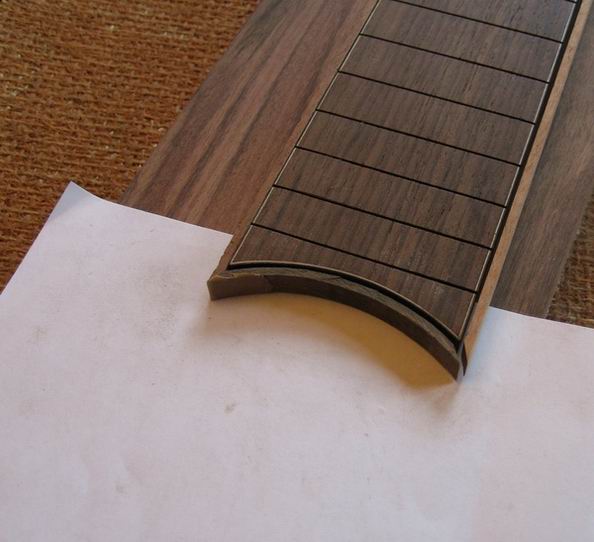

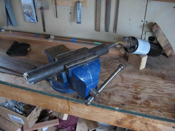

Now for me, the extention mimics the soundhole. I used my very high-tech bending apparatus pictured here: (note the technology dripping from that crepe block!)
Once the little piece is bent at the right angle, it's back to the bench-top sander to give it the right angles. For me, it's a lot of back and forth. I take off a bit off here and there until I'm satisfied with the fit. I know it sounds very obvious but make sure to have a piece significantly longer than you really need. The sander can take quite a bit off without you realizing it.
When I get eally close to the final fit, I'll swith to a hand file to take off last thou or so... or maybe not... it's up to you! I want the dry-fit to be as perfect as I can get it.
Voila! Just needs some glue...

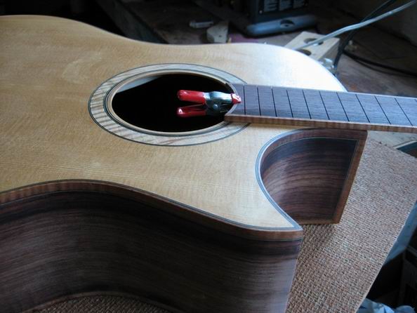

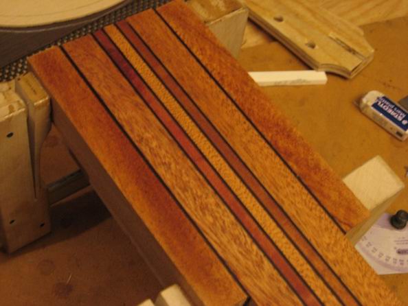

Oh yeah, this is where this FB should eventually wind up. Atop my 9 piece laminated neck (actually 13 if you count the 'extentions' with their lams - shown here just clamped on for a visual).

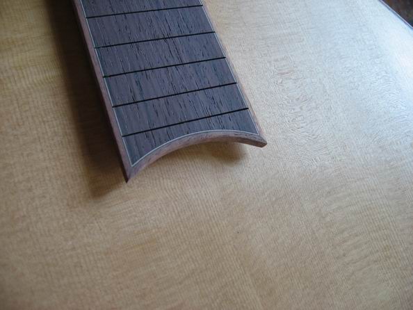

O.K. so here's the outcome. I used my ever favorite HHG to do the glue-up...
And here's where it should rest...
Thanks again!
