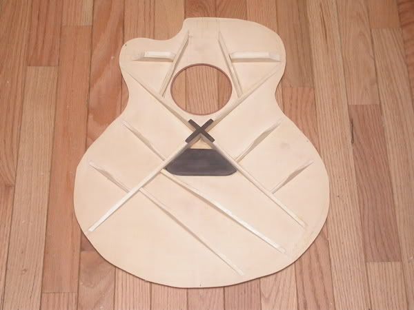

OK, here's the top:
2007-04-07_141328_6er_top.jpg">
Braces are 1/4" wide for the finger braces and lower face braces, 5/16"
for the X-braces and soundhole braces, and 1/2" for the upper face
braces. The soundhole braces will be butted up tightly to a mahogany
fingerboard support tongue extending out from the neck block. Bridge
plate and X-brace spider are African blackwood, about 1/8" thick. X-
braces are 3/4" high, the rest are about 1/2" high.
The top is Engelmann spruce and the braces are all Adirondack spruce. As
you can see, I've done some shaping of the braces already, but there's a
lot more to be done. If the braces are their final shape, they need sanding
and smoothing at the very least. The sound is lively and loud, but I'm
stymied by the situation that I don't know when to stop carving the braces
until I've gone too far...

From the look of the top I'd say the lower face braces may need a bit
more of a triangular profile as it does not reduce stiffness much but it
lightens the top up. The brace size looks ok though. The x looks pretty
beefy in the center, but then looks like it tapers down quite a bit. I'd
leave them alone. The finger braces look a little big, but not much. More
so than anything I like to have the peak of my finger braces cloe to the X
than what you have, but that is not to say I'm right..I'm sure yours are just
fine. Of course all this is based on the assumption that the top was really
stiff to begin with.
All in all I think you could just leave it all along and be fine. How thick is
your bridge plate? How thick is your top?

Pat-
If you can get your hands on a copy of
Kit Review: LMI's OM Guitar by John Calkin
AL#74 p.48
in the GAL publications, there is an interesting sidebar called 'Ferrari OM' on lighter bracing for a personal guitar.
Also, a good search in the archives (or a request for sample pics in a new thread- this could be a good resource for everybody) should get a bunch of pictures showing typical bracing sizes.
I'd say your pic (with 5/16 X, blackwood x cap rather than spruce, hefty transverse brace) would be toward the conservative/heavy end of the range, but not extreme at all.
You can't go far wrong with John Mayes 'stamp of approval'- he's seen a lot of guitars and can translate from bracing appearance to sound better than most of us.

Yes, I haven't shaped the lower face braces yet, and I was wondering how
light they should be. The top is pretty stiff - stiffer than other Engelmann
I've worked with and it's about 0.100" thick. I plan on thinning it slightly
around the perimeter just prior to finishing (more violinmaking
background - good violin tops always have a thin perimeter 1/4" or so in
from where the top joins the ribs) but very little. Bridge plate is about
0.110 - 0.120. The blackwood is REALLY hard! Should resist the ball ends
of the strings well. The finger braces seem awkwardly high to me - I
peaked them for the hell of it, and I'm considering lowering them a little
to see what effect that has on the tones coming from the ends of the
bridge.

Pretty much what I thought. The bridge plate did look thick to me but since
your top, for englemann is pretty dang thin that might be a good thing to
provide extra support on the bridge...I'd be cautious at going much thinner
than what you got and don't do a lot of perimeter sanding. I did that on a
really stiff cedar topped parlor one time an dI had to re-top the guitar
because it was building so bad..the top on it was about .110. Of course
cedar and spruce are two totally separate beasts.
All in all it looks like you've done a fine job and I would not do much else to
the top as it looks, aside from the center of the X, pretty lightly done.
