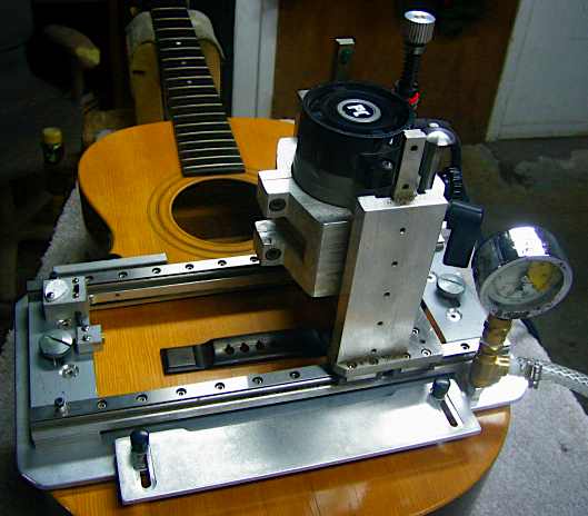

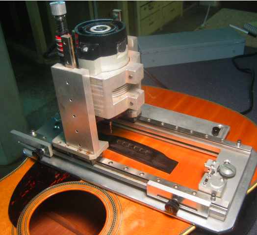

My mill is of a different design, but here's a few shots. The main
points are the same (1/4" shank lam trimmer cutter, linear
bearing travel and plunge, width and depth stops) with a
slightly different layout. Here is a top/side view on a new bridge
I had to slot this morning.

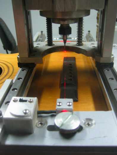

I know it's a bit silly and superfluous, but I just couldn't resist
taking the bulb and lense from a cheap laser level and
mounting it on the carriage.
05_223530_bm2.jpg">

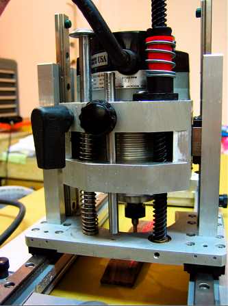

Here is the back with a lead screw for plunging on the right, a
depth stop in the middle, and a spring balance with a lock lever
on the left which I never really use.

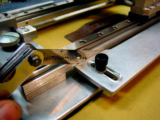

This is a shot of the other side with a view of the end stops that I
use. This slot I had to widen out and clean up this afternoon.
05_223943_bm4.jpg">
And on the front side put another stop for odd width slots that
may require moving the carriage for a second parallel pass.
05_224141_bm5.jpg">
When I made this I thought for sure that I had spent way too
much time and money in making this tool. Now that I've been
using it though I can't imagin going without it. Making a good
laminate trimmer saddle mill is an investment you will always
be thankful that you made.

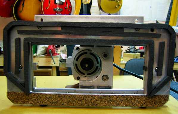

I was going to post a shot of the vacuum clamping bottom of the base,
but for some reason I can't get the image link to fit on one line in the text
box today. Maybe I'll try again tomorrow.
PostPosted: Mon Apr 09, 2007 12:32 pm
Posts: 2060
There, I got it to work.

Thanks for posting that bottom shot with the vacuum seals. I built one of
the Joe Woodworker vacuum clamping systems but have yet to fully
integrate it into my shop. Again being an eBay scroung-o-holic I may
have wound up with a vacuum pump that is slightly underpowered for
what I'm asking it to do.
