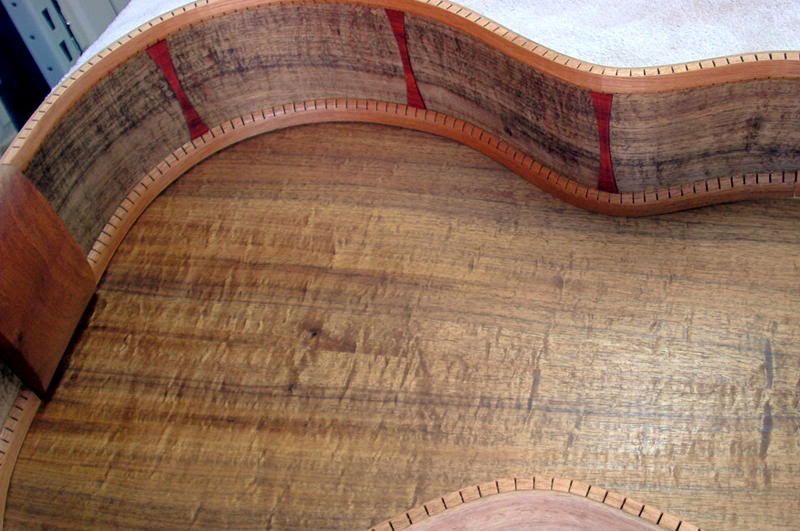

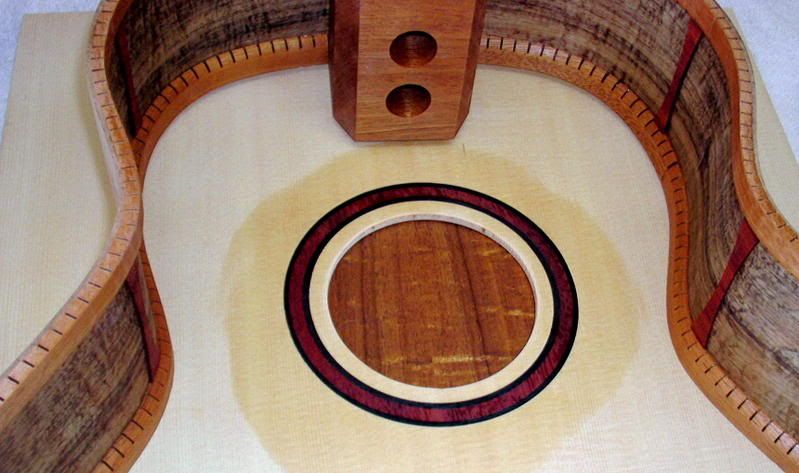

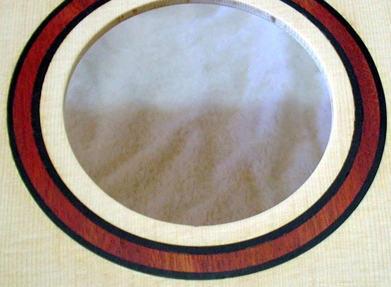

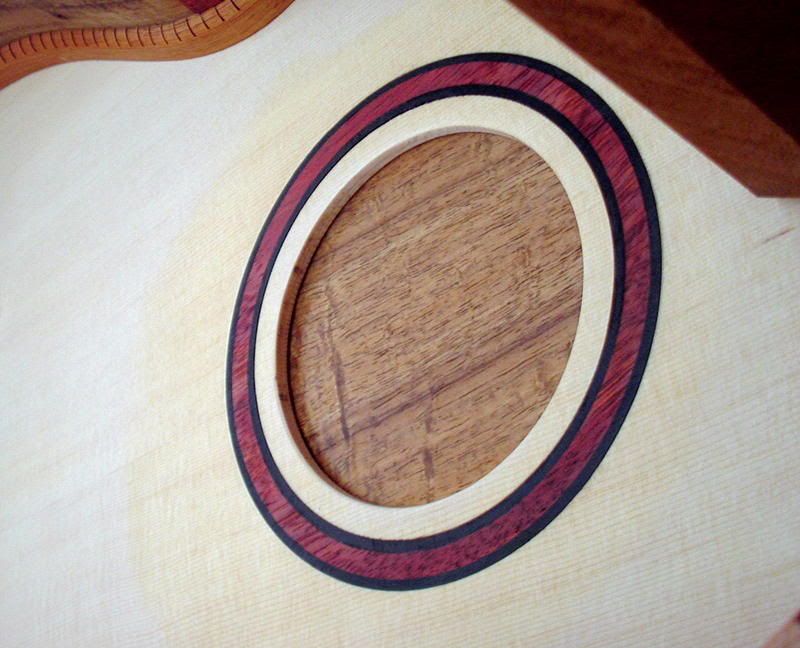

Following Hesh's lead, I thought I would share a few pics of a rosette I finished this weekend (well, a little clean-up is due as you can see). Anyway, this guitar will have mostly bloodwood and ebony appointments so I think the rosette might work well.

Looks good. I like that htecolor will match with the side bracing. The color scheme goes together well.

Thought I would switch things up on this guitar and put all of the pretty stuff on the inside
The bloodwood is inlayed into the ebony, everything drum-sanded to thickness, then the ebony cut out with a cicle cutter. As you know, it's a delicate operation, tricky little things these rosettes are.

Fine, tight, clean work Greg!
I also noticed that you were putting your rosette on the inside, and was thinking how unique that approach was.
However, in retrospect, I realize that Paul Woolson also puts his rosettes on the inside of his guitars.
Hey, it works for him...
Good job,

Are those hour glass shaped side braces made of bloodwood?
Also, I’ve been seeing a lot of reverse kerfing on guitars lately. Is there an advantage to it?

Yes, those are bloodwood side braces made with the same jig I use for making my tail inlay piece. I've always used the reverse kerfing, seems to work nicely, I certainly don't have any complaints....not sure if it is any better than the other versions though. Thanks for the kind words.

Looking good man. I bet the bloodwood will bring out a little red in the walnut... At least I assume that's a walnut body.

Hi "Lex"....thanks, it does look like walnut in those pics doesn't it, it is actually Austrailian Blackwood which is more obvious when you see a photo of the back.
