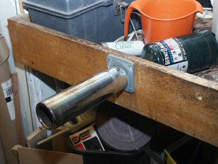

I used a chrome tailpipe tip for years to do venetian cutaways before i went over to a fox style bender. The tailpipe tip come with the screws to attach it to something. I attached it to a base I found in the electrical dept at the local home depot.
PostPosted: Tue Apr 10, 2007 5:18 pm

Ed-
Neat improvisation- I like it!
I put a metal baffle in the end of my horizontal propane bender- it saved a bit of damage to the belly button, but I still kept fairly clear of it.
PostPosted: Wed Apr 11, 2007 2:32 pm
Posts: 299
John,
I made that same modification later on just for that very same reason!

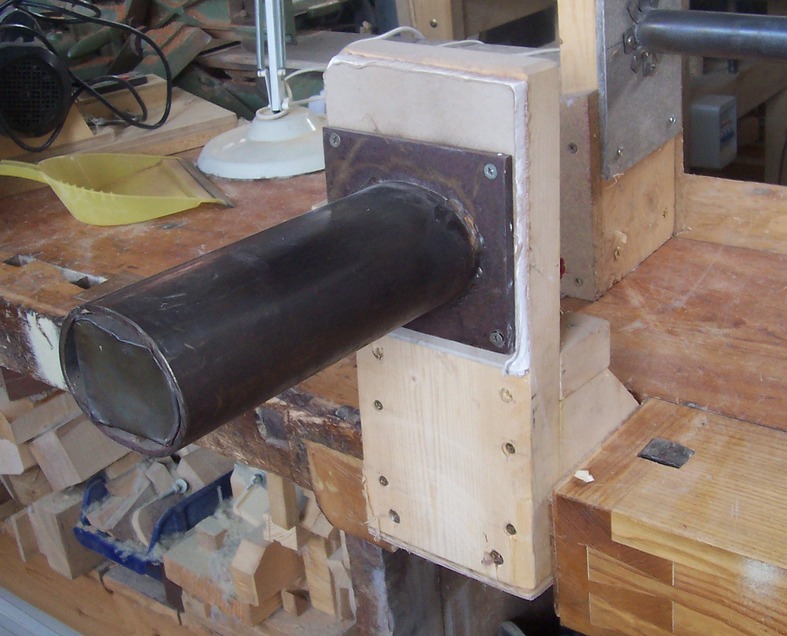

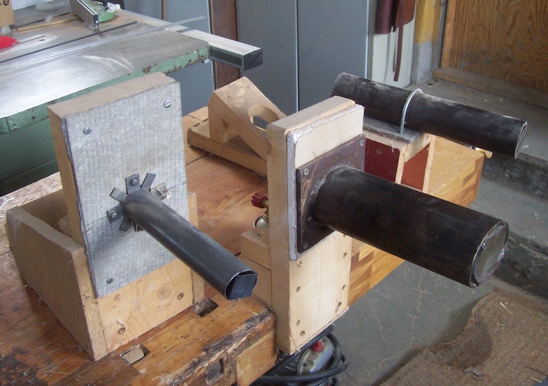

Here are some pictures of my pipes. I use 3 different sizes, all heated by propane torch (because I had one and it works!). They are all steel of varying diameters and thicknesses, mounted on some scrap wood bases.
The one on the left gets used for things like mandolin ribs, but it has thin walls so it does not retain heat so well and it can also scorch the wood if I am not careful. The middle one is the one I use for guitar sides, it is 4" pipe that is somewhat flattened into an oval shape and welded to a flange. The one on the right is just really thick walled 2" steel pipe, but it is hard to get it hot enough so I don't use it much. I now mostly use these for touch ups as I have a Fox style bender.
Here is another shot of the one I use for guitars. To check the heat I spray water on it and see how it dances. I folded some tin to cover the end a bit, it seems to help retain some of the heat.
Here is the back, you see how the propane torch blows its flame into the a hole in the flange.
No beauty prices for these, but they are easy to make, reliable, versatile and best of all, cheap; just like me!
