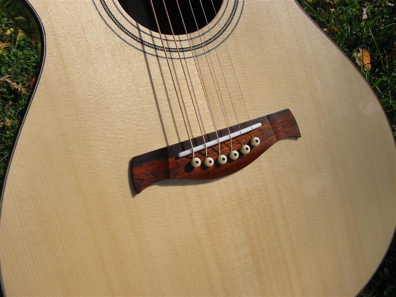

Jay, I used coco trim on a recent grenadillo grand concert guitar, including a coco bridge, whick I just removed this week to thin down a bit, along with some brace revoicing. It came out well, sounds much better too. I weighed in at just over 28 grams when originally, reworked it came out to about 23 grams. I wanted it to match the trim, and it seems to be working well.

Yeah Hesh, I too am concerned. That's why I haven't (maybe WON'T) build a coc guitar. Least till I have absolutely the BEST dust collection I can get. Down draft table, air cleaner, etc. Thanks for the complements. It's the one bridge in use when I borrowed Lance's jig.
