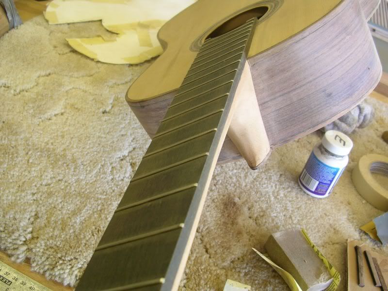

In the middle of my first build here, was looking for suggestions on hiding the fret slots on a non-bound rosewood fretboard.  Was pretty proud of myself for tapering my first fretboard, routing the truss rod slot in my first laminated neck, then glueing the fretboard on and shaping it perfectly....then I realized I forgot to allow for the binding.
Arrgh!
So.....melt in some black lacquer after fretting and THINK BEFORE CUTTING next time?  Does anyone intentionally NOT bind the fretboard these days?
