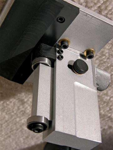

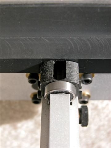

These are pix Hesh sent me. He'll have to elaborate
PostPosted: Sun Apr 15, 2007 2:43 am
To let you know Hesh has moved away from that jig and is now using a Williams/Fleischman style jig.

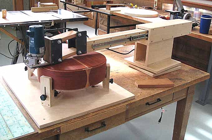

The Williams/Fleischman jig is larger, requiring more storage space and space to use it but because you are moving the cutter and not the guitar it's probably considered the easiest to use.
the Ribbekle (sp?) style like the second picture also requires a larger working area and storage of the jig, you move the guitar on the body holder, little bit more technical to use but still effective.
both these two generally require a rabbit type bit and bearing set which can add to the cost of the jig.

over the years i've built and used a number of binding routing jigs, both the sort which index off the sides, and both the common types which index off the top, that offered by lmi and the williams design( look in the jigs and fixtures section above). to me the jigs which index off the top are preferable because it is much easier to maintain a uniform channel, but they do have the disadvantage of requiring more space for storage and use.
of the two common top indexing jigs, i prefer the williams type despite it taking a bit more time and material to build. for me, it is much easier running the router on the instrument than having to move the instrument under the router, especially when one takes into account the need to route down hill to minimise the risk of chipout. also takes a bit less space to use, but occupies a bit more in storage when not in use.
both do a good job.

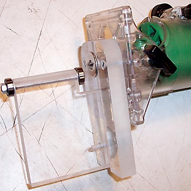

The first picture in this thread shows my simple binding jig. Here is a thread with more pictures, a drawing and an explanation of how I use it.
Arnt Rian's binding jig
I have no experience with the more elaborate binding jigs mentioned, but my little jig cuts so cleanly and is so simple to operate that I don't feel the urge to make a more complex one. If anything, I will probably make another one like the one I have and leave one set up for bindings and one for purflings so I don't have to change the settings every time, which can be finicky.

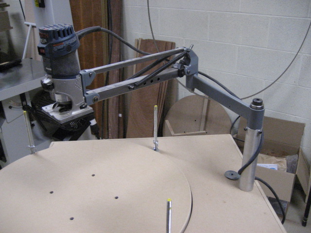

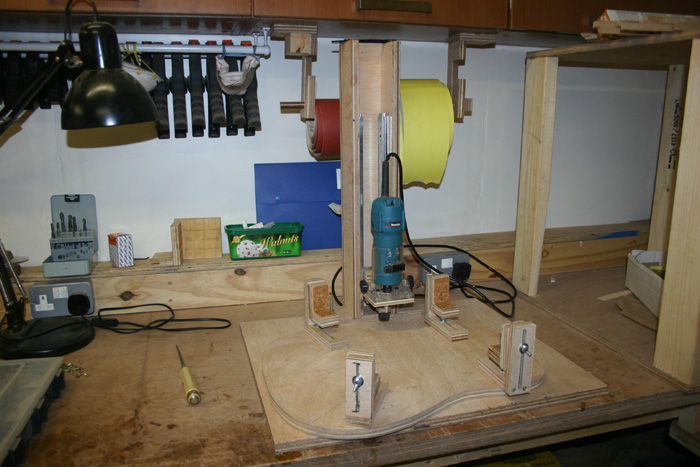

Here is just a different approach for a compact binding jig. The basic jig is a "Balance Arm" I found used at a industrial surplus warehouse for $30. I have seen similar items on Ebay. I had to adapt the end to fit my Bosch Colt. With a little creativity I am sure this could be built from hardwood and standard hardware. In this picture I mounted the jig to the back of my dish sander so it can be swiveled out of the way when not in use.
Good Luck!

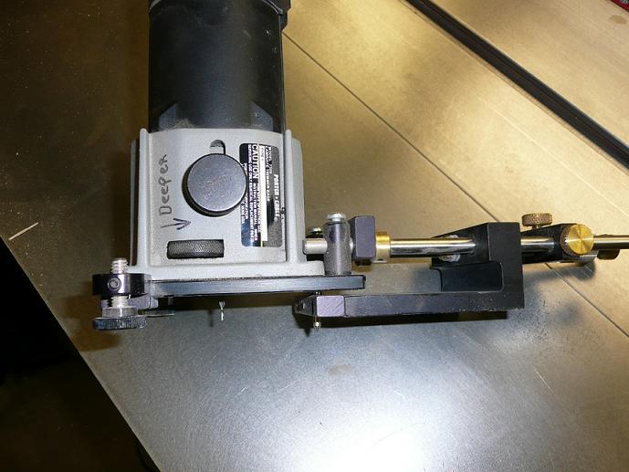

Hesh,
I built a jig out of phenolic that looks just like yours.  I didn't have any problem with tilting it into the guitar, the geometry of the shoe prevents that from happening - at least with mine.  I use a down cut 1/4" spiral carbide and it did a very nice job.  If I wasn't so lazy I'd go out to the shop and take a picture.  I used fine threads on the lead screw so the adjusment is very precise, indexable and repeatable.

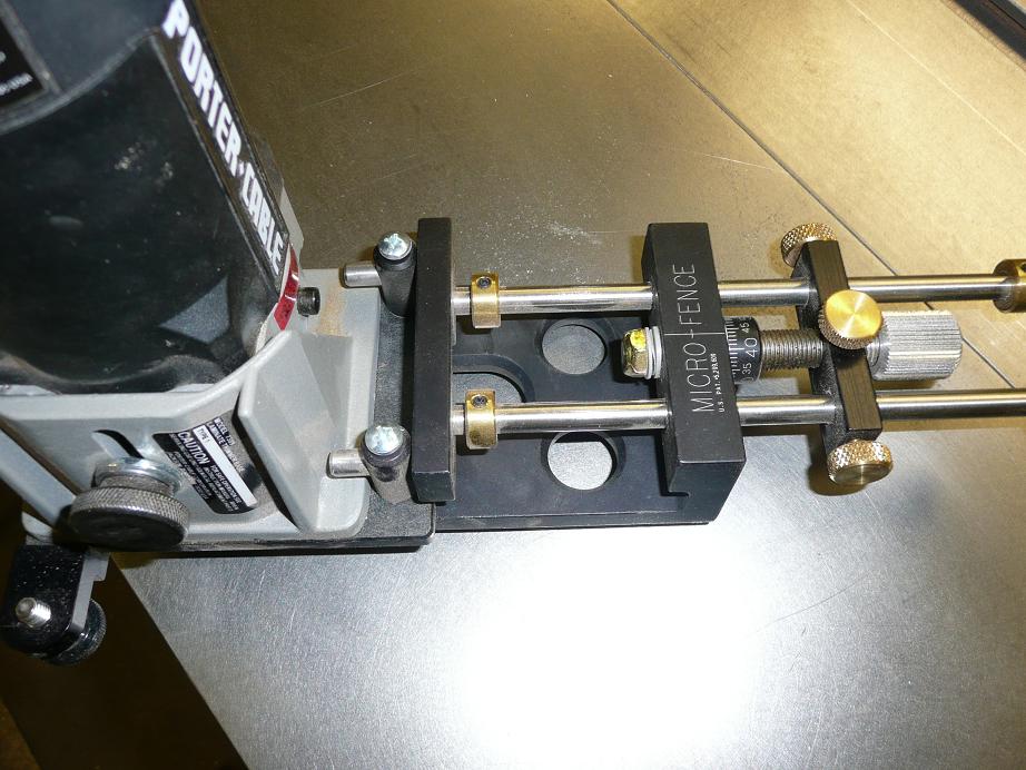

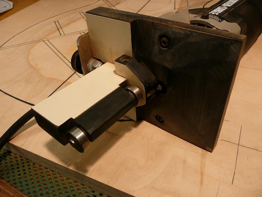

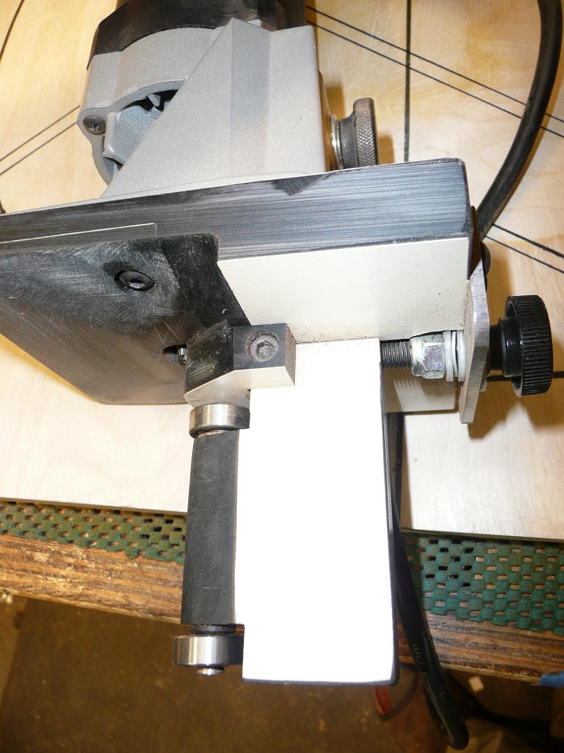

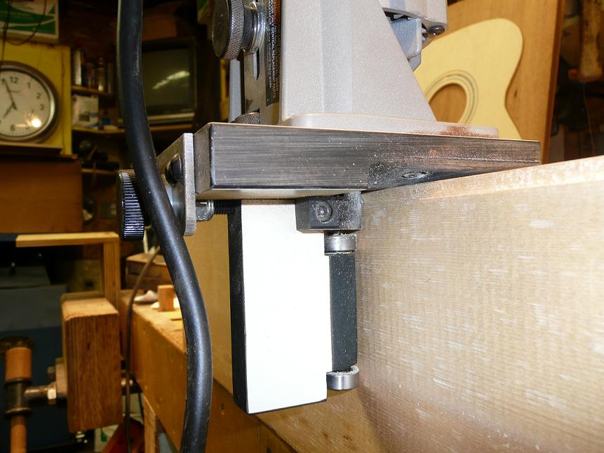

Hesh, here's some pics of my home made jig.
And while were at it a couple shots of the Micro Fence jig for cutting rosettes and such.  This is a wonderful little tool.  Grizzly sells down cut spirals as small as .023", which allows you to cut in VERY small purfling lines at the rosettee.
