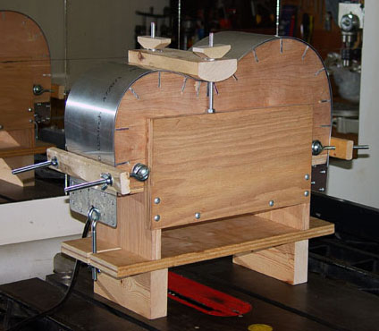

I built the side bender described on the J.
C. Jones website http://jcjonesguitars.netfirms.com/sidebend.htm
It uses three 150 watt bulbs with ceramic sockets.
I used 6061 T6 aluminum for the slats from an aircraft materials supplier. I did not use a timer because I felt that it might encourage me to lose sight of the very hot bender. I keep my eyes on the bender while in heat.
My total cost was approximately $50.00.
It works.

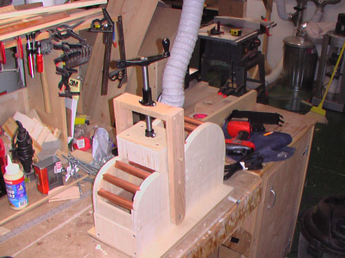

For what it's worth, I built my own bender as well and used three 150w heat lamps with the ceramic bases.  I think that eventually I'll go with the blanket too, per everyone else's recommendations.  Not shown in the pic are the front and rear clamps, guess I took this pic in mid-assembly, sorry! And no, the dust collector hose is NOT hooked up to it.
The whole deal, including the press screw, only set me back about $40.00.  Best of luck!
Jon
