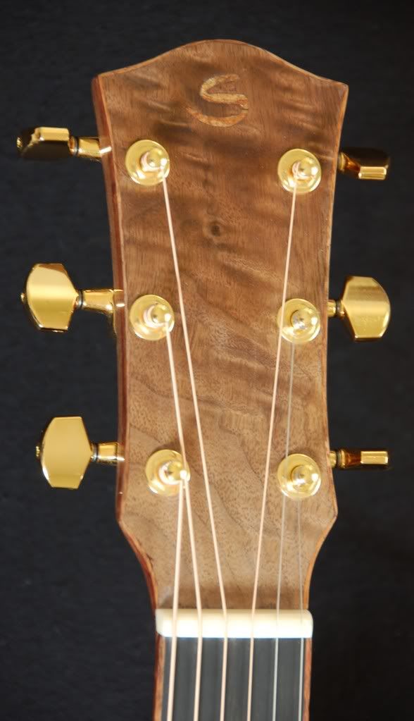

This is the fourth guitar I built.
I wasn't watching the spec sheet close enough and I made the neck 1 3/4 instead of 1 7/8. After about a year my friend mentioned
that while he liked the sound, he couldn't play it very long because the small neck hurt his hand.
So what else could I do? I asked for it back and made him a new neck.

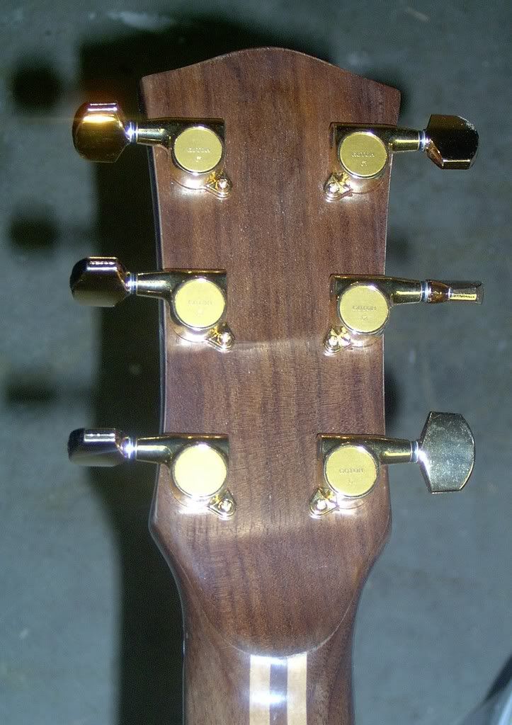

The old neck was mahogany/maple/walnut with a rosewood fingerboard. The new one is walnut and maple with an ebony fingerboard.
There is subtle tonal difference. I think it is more dark, with perhaps a bit more sustain. This is my first walnut neck, in fact it is my first neck in anything but mahogany.

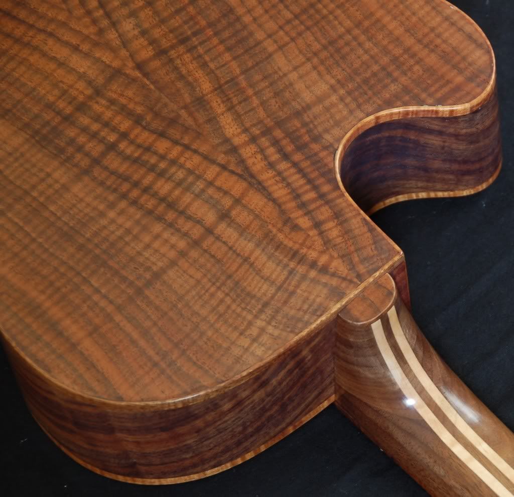

The guitar is cedar on walnut. I love the walnut on this guitar, while many of you probably saw it about a year ago, I thought since I had the pictures,
some of you might enjoy seeing it with the new neck.
Walnut headplate with spalted maple S.

Some of the prettiest walnut I've ever seen.
Nice guitar, and new neck, thanks for sharing the pics.

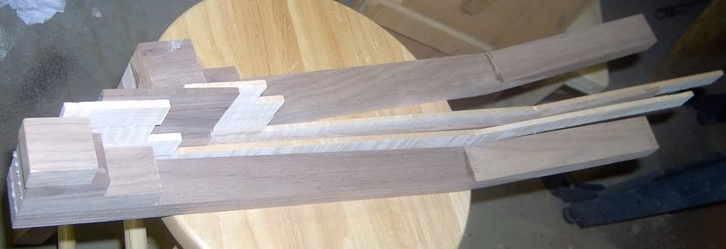

Steve, Looks great. I presume that’s a laminated neck but then I see a stacked heal.
I think of a stacked heal with a scarf joint. Would you mind going into a little detail about your method of neck construction?
PostPosted: Wed Apr 18, 2007 3:20 am
Posts: 1969
PostPosted: Wed Apr 18, 2007 3:23 am
Posts: 1969
Dave,
It took a bit of learning to get it right. I make up the blanks as shown in the picture above (I would love an edit feature here), run them through the drum sander, and glue them together.

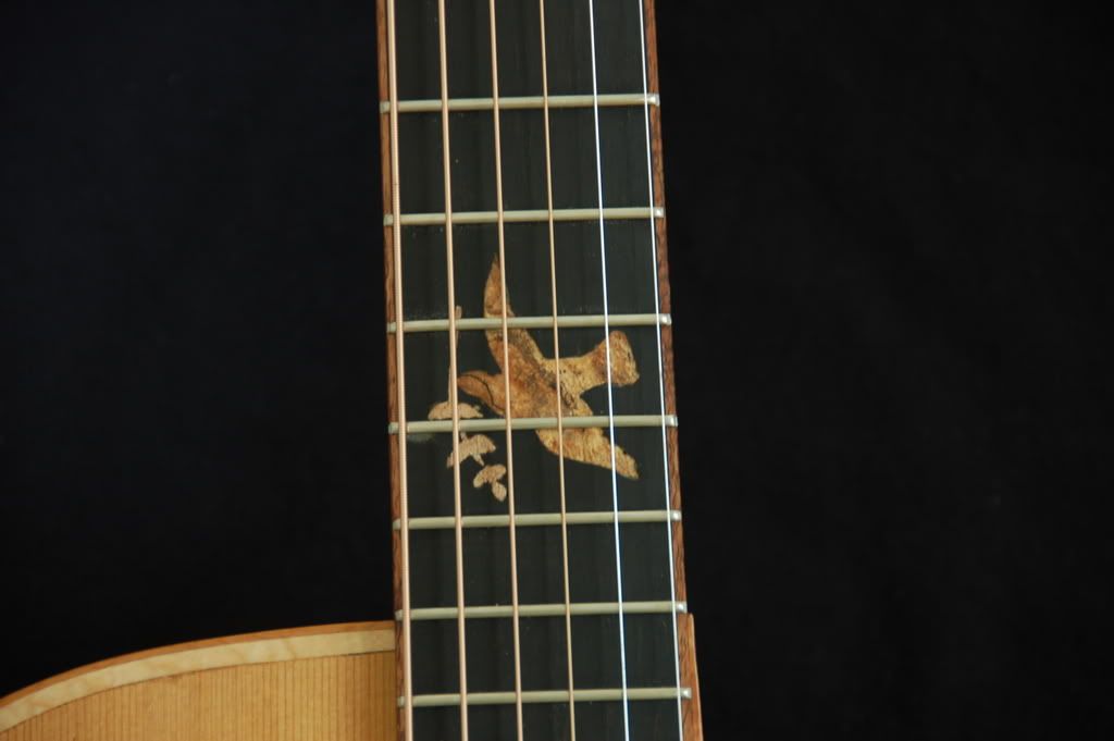

Beautiful work Steve!! I like the inlay. What is the material specifically?
