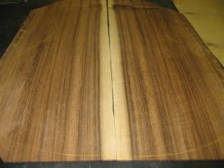

Thanks - the reason I asked was that I had a similar reaction from a supplier.  He doesn't build guitars (but sells tonewood), so I was curious what everyone else thinks.   I have had only one "oops" which was totally my fault.  I was planing a piece of lightly figured Mayan Walnut (from LMI), was in a bit of a hurry and took too much off in one pass, resulting in a small chip.  It falls under the neck block, so no worries with that one, but it opened my eyes to the potential for problems with other woods
I am surprised how clean the wood comes out, a pic of the mayan walnut is below which hasn't been sanded yet.
