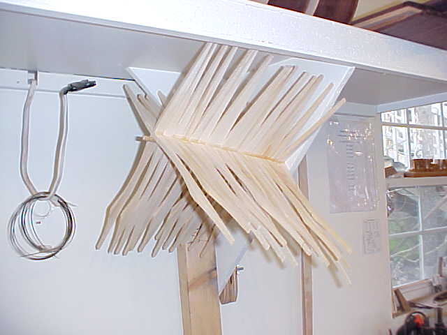

Scalloped Adirondack Braces to love. Just wanted to share a picture of 17 of 20 made last week. Have a great day, It's Spring down here!
Chaos:
Organized:
25' Radius, perfect quarter, stress tested, super-glued joint, and gets a top cap at glue-up and tapering sides toward the peaks. Dickey38418.4200462963

Love the storage system!
PostPosted: Mon Mar 07, 2005 6:57 am
Yup. A 5/16th " dowel rod glued in the upright.
