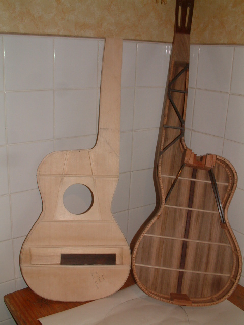

Here's the rim set with the back attached showing the cf flying buttress braces and the cf lattice braces for the hollow neck carrying the 6 sub-bass strings:

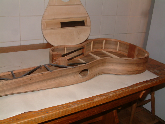

A side view showing the soundport:

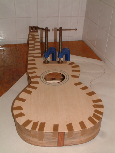

Top signed next to the box, ready for glue up:
Top glued on - I'm using fish glue for this for the first time:

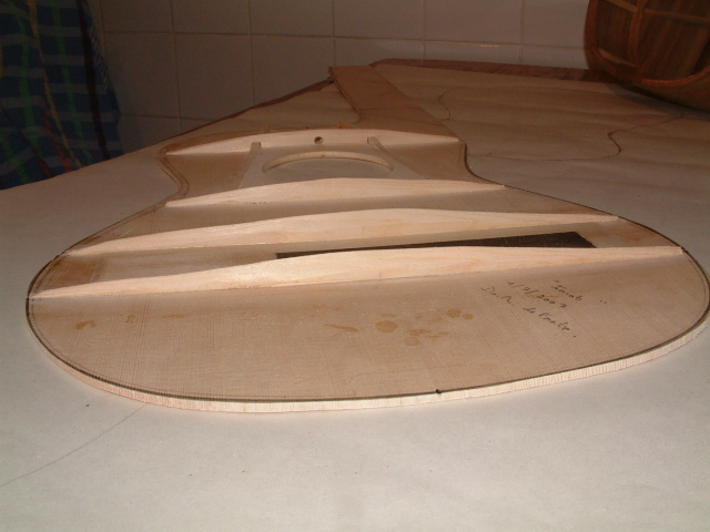

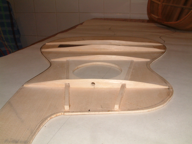

A couple of views of the "triabolic" bracing. The braces are just under 6mm wide and vary in height between 13-16mm at their tallest:

The hollow neck bracing pattern is commonly used for floor trusses.

They probably don't. The flying butress braces I do in all but my Weissenborn guitars and the carbon-fibre lattice on the hollow neck was done from the ends of cf rods that went in my necks that I kept thinking they would come in useful. Hopefully they will give good stifness and resistance to the 6 sub-bass strings pull for virtually no weight.

The top varies in thickness now from just under 2.5-3mm. It will be thinned around the perimeters to leave it about 2.8mm in the centre , going down to around 2.2mm at the edges.
