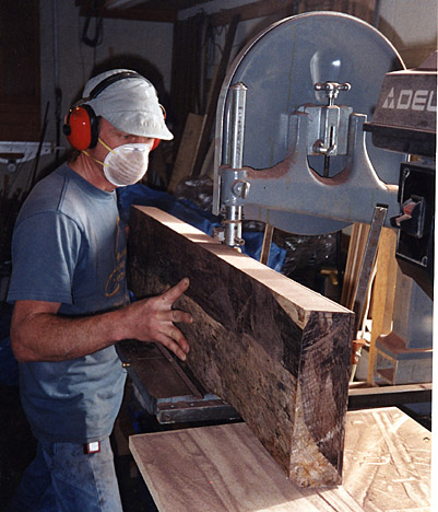

Posts: 332
Sawing 9" wide Brazilian on a 14" Delta with a 1/2" 3 tpi blade and a 5/8" hp motor. The saw has a homemade 3" riser block.
I had two of these billets and sawed 18 sets.
It was not fast, but the results were very good.
Mark
PostPosted: Sat Jul 14, 2007 1:27 pm
Posts: 404
Great photo Mark!
