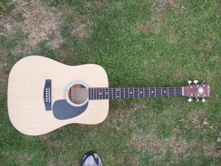

As Promised, here are results of my first inlay project, and first
guitar.  I must confess, the guitar itself came from a Grizzly
Industrial Kit.  It was my first and I had a lot of help from Mr.
Murphy (Murphy's Law).
I actually gave the guitar to a longtime friend of mine who coordinates
a music festival in North Carolina.  He calls it Ulu Katu and used
a Sun logo each year for banner, t-shirts, ect. . .
The hardware for the guitar was not the best but the wood was great and
I think with better hardware it would be a great guitar for the
price.  I replaced the headstock veneer with rosewood.  (it
was some cheap-looking stuff).
Thanks for all the help I got with the inlay.  As you can see, it turned out good enough for a first try.

I really like that sun inlay....I think you might have given me an idea....
PostPosted: Sat Jul 14, 2007 2:41 am
Very good job on the inlay and guitar!  I, too, love the sun and the differing shades of the sun rays makes for an interesting inlay.
Keep up the good work!
PostPosted: Sat Jul 14, 2007 4:11 am
Joined: Wed Apr 25, 2007 12:45 pm
Posts: 16
Thanks.
Sun Inlay Story:  Actually, in my last topic a few months ago I mentioned that the Sun was made of Pearl and walnut Stained black.  I used ground up African Blackwood to glue the inlay together.  The epoxy I used to place to the pattern on the headstock sucked all the stain off the walnut
I tried to re-stain it with no success due to my deadline on the project.  It doesn't look like it was intended.
