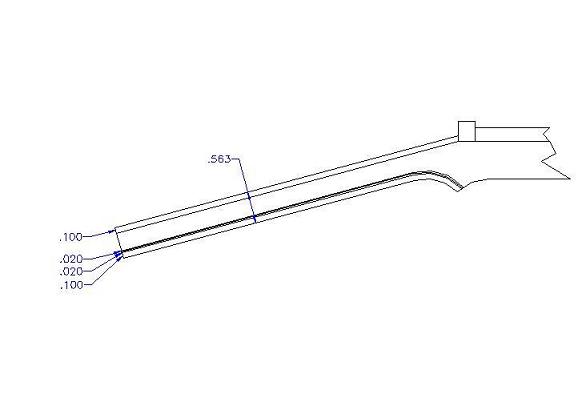

Great timing on this. I'm in the process of thinning my headstock.
I have a .100" rosewood head plate for the front. For the back I wanted to lay 2 layers of .020" veneer plus another .100" rosewood plate.
So that means I thin the head to .323" does that sound right? Or does the rosewood need to be thinner? Also what do you do if you have a volute?
Sorry for the hijack Donovan.

PostPosted: Fri Jul 20, 2007 5:03 am
[QUOTE=Kirt] Great timing on this. I'm in the process of thinning my headstock.
Thanks[/QUOTE]
No, you want it .4222" if you want it to be 9/16" thick -- a little more if you want it to Mark's specs.

PostPosted: Fri Jul 20, 2007 6:02 am
Posts: 493
Ok, here is what I see inside my small brain.
.100 rosewood on the front.
.100 rosewood + .020 +.020 veneer = .140" on the back.
Is this do-able or should the rosewood plate on the back of the headstock be thinner? I should be able to bend it on a hot pipe, no?

[QUOTE=Kirt] Ok, here is what I see inside my small brain.
Many thanks,[/QUOTE]
Kirt-
That should work.
You might want to consider using a 'symmetrical' arrangement of veneers- ie similar top and bottom, but this can depend on the colors of the woods you are using.
If you think you are going to have trouble bending the RW, you can use a bigger radius for sanding the volute, though this is usually limited by the tools (end of belt sander, 3" drum, etc) that you have on hand. The thicker the overlay, the less it will 'bend' to give a good tight glue line, so you have to have a good caul and a smooth bend. I've only done a few, so you should keep this in mind when evaluating my recommendations!
One thing to keep in mind is that the nut is usually between the overlay and the fingerboard, and a thick overlay will change the string angle over the nut a bit. I wouldn't think that 0.100 will cause any problems.

Thanks Brock & John,
The volute will be flatter than in the drawing. Just a quick sketch. And it will probably be down the neck just a tad too.
