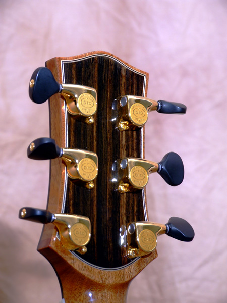

I Got this one finished up last week but just got some pics of it. This is one of my Healdsburg guitars. The background colors came out kind of pinkish in the phots but the wood colors look right
Details:
B/S - Bastonge Walnut
Rosette - spalted maple (first one I've done)
Binding - Claro Walnut
Bridge/finger board - ebony
top - Adirondack Spruce
Thanks for looking.

Dang, that's purdy. I dig the back of the headstock.
PostPosted: Tue Jul 31, 2007 4:43 pm
Very very nice Jim. love it all, Bastogne Walnut is great looking wood and the bound inlaid veneer on the back of the headstock is such a very classy touch indeed.

How did you do that peghead back?
PostPosted: Fri Aug 03, 2007 1:49 am
Got to love that Bastonge walnut !! Great job!
Yes,How did you do your peghead back?

In response to "how did you do it?"
Well I have a pretty cheesy cnc router, it's ok, but I had to rebuild a large chunk of it to get to work, but it does work now.
I made a fixture like so..
The neck locates in the truss rod slot and the peghead against the base. I cut the headstock outer profile and the pocket for the inlay in this fixture.
I'm pretty sure this could be adapted to hand routers however with a little modification to the fixture.
This could be accomplished by pinning guide templates to it for the router to follow.
The key to getting it come out well was to install the purfling lines first, then the inlay piece.
I cut the inlay just a touch big and used a scraper to fit it into the purf lined pocket.
Hope this helps with some ideas for someone.
