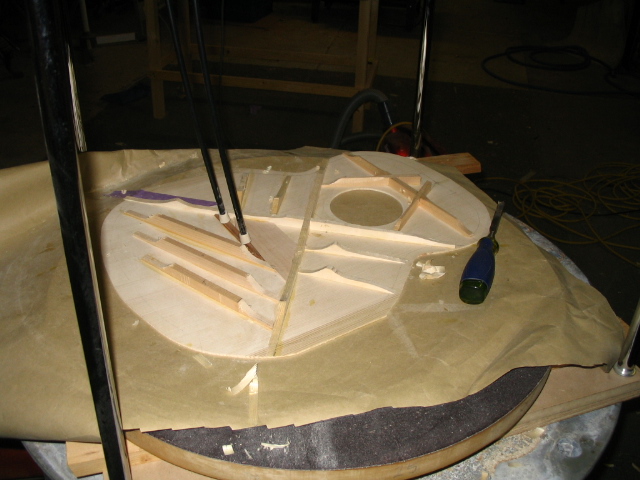

Mount your workboard on a steel post bolted to the floor and put vacuum gasketing into it.   Then you have the top vacuum clamped solidly and you can walk all the way around it.
PostPosted: Mon Sep 03, 2007 7:43 am
Posts: 1667
And how does this work in voicing a top?
Surely helps you cave braces, though....
Another simple way to secure your top for brace carving(and other functions on other items) is to have a few holes in your bench top, and a few, short,  1/2" dowels handy. Two or three will hold just about any object for chiseling, planing, etc...

Our go-bar jig is on a round table.
Throw a couple of go-bars in we can walk around it to carve.
(actually were lazy and and sit on a chair with wheels)

    I've used a similar dish rig for several years and like the quick access it
gives to all braces from all angles without having to move around the
bench at all.

I'm with Bob here, I just use my go-bar station, mine has no vertical supports to get in the way giving good access. A couple of bars to hold the plate in place, a few second work to take off the bars and rotate the dish.
PostPosted: Mon Sep 03, 2007 10:21 pm
My glue room space is confined. I like it that way because there is less RH to control. The top of my gobar deckdeck is a 600mm square, 38mm thick, piece of MDF which is suspended from reinforced ceiling joist by 4 x 7/8" threaded rod and it hangs directly out from the main bench with no vertical supports to get in the way. It also has a light installed under a rebated 100mm square 10mm thick piece of plate glass and this lets me see whats I am doing.
The bottom part of the deck is also a 600mm square 38mm thick piece of MDF but this is hinged to the apron of the bench and forms a drop leaf directly below the suspended top. This leaf simply folds down with the removal of a prop and, in this position, it sits flush to the side of the bench and is out of the way when not required.
In the bottom centre of this drop leaf base is a "T" nut which has been epoxied into place to accept a headless 1/4" bolt which can be screwed in from the top. When required, the headless bolt is screwed into place with the threadless section left protruding from the centre top surface of the base. The radius dish, which already has a 1/4" hole part way through the centre from the process of it's own manufacture, may then be slipped over the headless bolt and spun anywhere you like on that pivot point.
This allows you to access the dish from 3 sides of the drop leaf, or just stand where you are and spin the dish on the bolt to meet you like a lazy suzanne. And you know what? One day, I'm gonna build me a guitar with that sucker.

I was expecting to see a voicing jig such as Ervin Somogyi uses. This is a clamping jig.
I clamp the plate to it's corresponding dish and carve away. I have access to 3 sides and have never felt it was a problem. I even enjoy the long walk around the "worksite" even though it's not as scenic as my 5 mile walk searching for that elusive white ball!

Terry, I like the way you threw some random wood curls on the finished top to give the effect you were still woking on it.

Bob, I was sliding down through this thread again and noticed your tonebars are reversed.
Is this a left-hand guitar?
Or, has the photo been reversed?
Just curious.... bd

Yes it is a left hander.
If you look very carefully near the tone bar nearest the bridge you'll see some faint marks where the braces have been chiseled off because some idiot glued them on the wrong way.
Yes it was me.
