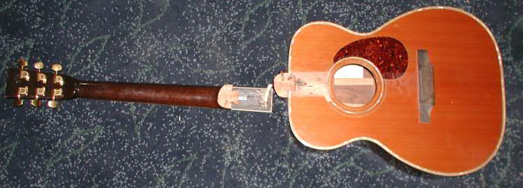

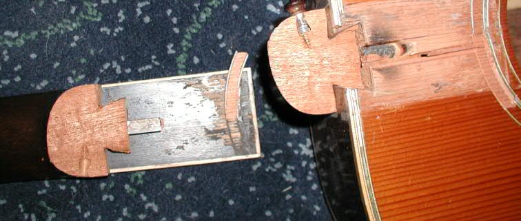

A coworker buddy of mine shared these pic's with me.  He lives in Austin, TX.  This 20 yr old hand made guitar needs a neck reset and he wants to put a truss rod in as well.  The rest of the story is...early in the guitar's life, his dog knocked the guitar off the stand and it landed in such a way that the neck broke off.  Since he took pictures of that fracture, we get an x-ray of sorts into the dove tail (and possibly a lesson in how not to install a strap button???).  Looks like it would be a challenge to pop it out cleanly, given the previous fracture and the lack of a gap between dovetail/neck block.  Any takers in the Austin area?  I could give my friend your info.

I would almost be tempted to take off the peghead veneer and fretboard if possible and build a new butt joint bolted neck for it.

You could probably easily steam out the piece still in the dovetail and rejoin it to the neck with with the use of dows and glue. It seems like the strap button might have been the culprit. Maybe the maker didnt drill a proper whole wide or deep enough. Putting some stress in that area. I'm sure a good repairman in your area could do a nice job with that.
PostPosted: Fri Oct 05, 2007 7:20 am
I would look at separating it from the neck with heat and a seam knife if possible, if not the band saw it off the thickness sand it down to just the veneer.
The neck is repairable The issue I am afraid of is the adding an adjustable truss rod.
If I am looking at the picture correctly the steel bar that is in there is not adjustable and is only reinforcement. Correct?
If this is the case it would likely be easier to fabricate a butt joint bolt on neck with rod access at the peghead than to try to modify that neck for an adjustable truss rod. If it were not for that I would say the repair the neck.

[QUOTE=MichaelP]If I am looking at the picture correctly the steel bar that is in there is not adjustable and is only reinforcement. Correct?
QUOTE]
Yep, that's right.  There isn't a truss rod.  I'm not sure what that is protruding from the neck onto the fretboard extension, but you're probably correct there as well.

Not counting changing to an adjustable truss rod. This would have bee an easy repair if the neck had not been glued bac togather.
If the Dovetail was steamed out before the glue up then it would have been a typicl neck set repair plus abreak repair.
Glueing back up was not the best idea.

I got the impression from my buddy that the neck fracture happened some years ago, was repaired at that time, so maybe (hopefully) the builder didn't miss a golden opportunity to set things straight at that time because they were already straight.  The combination of the prior fracture and the lack of a gap behind the dovetail made me think initially that it would be a difficult removal, but it sounds like it might not be so bad, and maybe my buddy can live without a truss rod.

Having done t before, and providing the same adice to AZ, the best way IMO to ge the headstock face off is to cut the headstock off, then resaw the rear off the headstock remaining, then thickness sand whats left till you get jsut the faceplate and binding. You might want to leave it a hiar thick as I woudlnt count on the binding and shell remaining intact if it gets thin. Same thing if you want to save the FB - cut the back of the neck off, close to the truss rod, then plane/chisel/sand until you can pull the truss rod out, then remove whatever wood is remaining on the back of the FB. I would then make a new neck, bolt on heel, fill the dovetail cavity flush, drill bolt holes and then coutersink with a bit like Frank Ford has (I made a similar one from a spade bit - just grind the flange area sharp and it will cut in reverse on the pull). Its a lot of work but not impossible - count on it being at least 1K - I wouldnt do it for any less ...

Do I detect a pushing in of the neck and neck block into the top? Or was the guitar made with the sided going in slightly concave at the neck attachment. And was that really a huge amount of wood filler there between the body and the face of the side of the heel?   Holy crap!
That sucker needs a new neck at the very least.   Save the peghead and fingerboard if you love them and have a decently fitted neck put on whether it be dovetailed (I wouldn't) or bolted (I would).
This is a perfect example of designing a guitar from the outside in and paying more attention to bling than performance.
