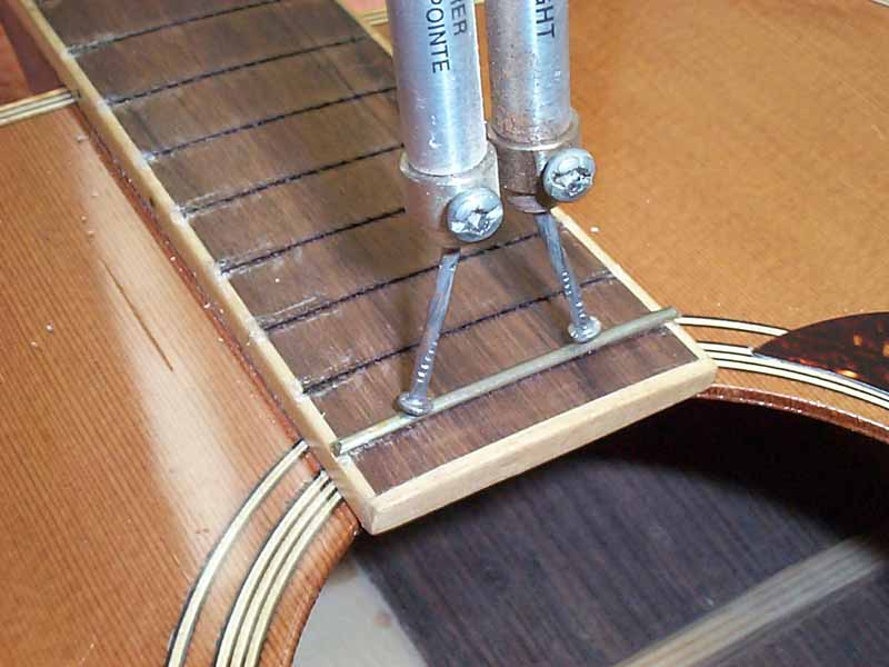

PostPosted: Thu Nov 01, 2007 4:54 pm
Posts: 2060
I'll have to check out that American Beauty system Rick. It sound great. I've
always just used an old Weller solder gun dedicated for frets. I cut a half-
round notch in the tip to ride on the fret, and have become kind of
automated in dropping the tip in to my pullers, which guides it on the the
fret as I draw it back. This one won't ever slip with the notch cut in it, but I
do have to sat I grow tired or replacing bent tips and notching out new ones.
Do you heat the frets on a sideways removal job? I don't know why, perhaps
because there is typically not any glue, but I've always done these cold.
Chipping problems have always been very minor, but I suppose they could
be less with heat to perhaps soften the wood..
PostPosted: Thu Nov 01, 2007 10:19 pm
Posts: 1667
Just stick a couple nails in your old soldering gun. I've been doing this for years; works like a charm. File a tiny notch into each nail so they stay put on the fret.

Great photos David, its funny the first guitar related job I ever did make my older P-bass into a fretless back in 82' or 83' I was about 14 years old and I had no tools so I hammered them out sideways only because I did not even imagine another way frets were put in at that time.
They came out pretty well if I remember. The only problem was it was a maple neck and made the worst fretless bass of all time
Mario I love those 2 nails you use. I may try that later today.
Thanks again David,

PostPosted: Fri Nov 02, 2007 1:18 am
Posts: 1398
The nail trick in the Weller works great, too. I just got all high tech when I found the resistance soldering station at a surplus store for fifteen bucks...
