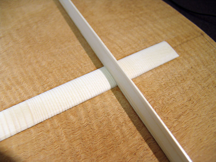

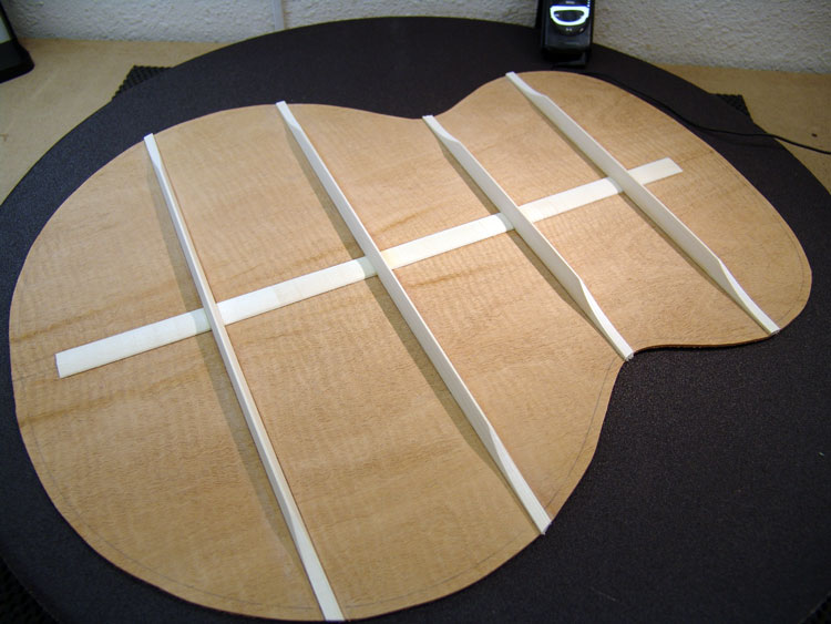

I had a great night in the shop tonight and finished the back of the Mahogany/Lutz SJ that I am currently building.
After seeing Lance's super neat work this week he makes it just that much harder to compete and I go through more sand paper trying....
So I put the tunes on, cranked it up, and went at it and here is what resulted.
Thanks for looking my friends

BTW this is your beautiful Honduran Mahogany

The intersection of the ladder brace and the back reinforcing strip is really a work of art.  I see no gaps.  Great work!

I still get amazed every time I see your work Hesh. For the life of me I cant keep my shop looking anywhere near as neat as you do. Beautiful job on the joinery too! Even your sandpaper is clean

Steve the top rings very well but I have not checked it out with my Strobosoft yet to see what note the fundamental is.  And right you are buddy the Festool helps keep it all very clean.
I made a discovery for me tonight that I am sure many of you already know but I didn't.  If you wrap the sand paper around a slightly flexible foam block sanding between the braces is a breeze and the flex in the foam follows the dome of the top/back very well.

Larry it's HHG and it cleans up very nicely if you catch it about 5-8 minutes after clamping.  And yes indeed Serge holds the unbroken record for the number of posts in the shortest time period AND for being one of the nicest guys who was ever on the OLF.  He is doing fine too and still building and his guitars are getting very nice these days.

Clean Work!!! Those braces came out real nice!!

Hesh,
You don’t just shape braces!
You sculpt them!
How do you get them to look so perfect!

Looks like you bleached those braces they are so dang white...nice looking back Hesh!

Beautiful work as always, Hesh. I can't wait to see her when she's done. That Mahogany is going to be something special under finish.
