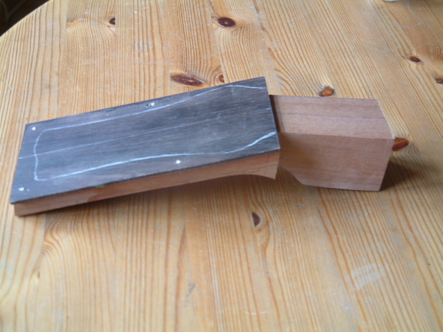

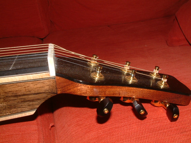

As you know I did my own things in terms of plans/design for my Lap-slides so if it's "authentic" they want this probably isn't it. But here goes:
Here are pictures of the head-block I made:
[QUOTE]
- How are the sides rabbeted into the head block?

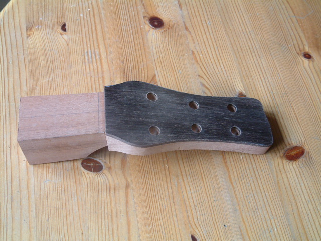

From the pictures you can see that there is a rebate for the sides in the head-block so that when they are glued they butt onto the headstock and the headstock is carved to meet them. When gkued up it looks like this:
[QUOTE]
- Is the top or back rabbeted into the head block?
No'ish . The top glues on to the top of the head-block, but the headstock veneer on the downslope forms a sort of rebate (see above picture). The back is glued on as well and then blended into the curve of the headstock bottom.

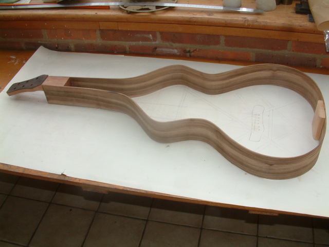

[QUOTE]
- Is the head block full depth, and how far into the body does the block extend?
The part of the head-block that is inside the hollow neck is full depth in terms of it having the top sides and back glued into it. I didn't take exact measurements but it goes back around 2-3" into the hollow neck.
[QUOTE]

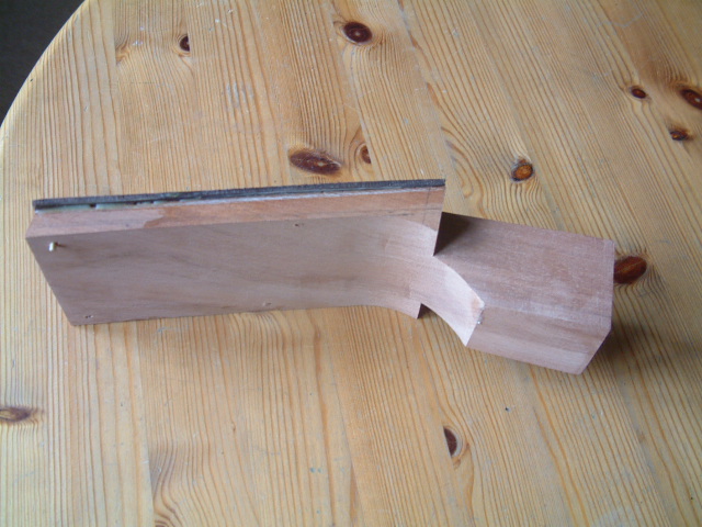

- Is the nut placed on the headplate or on the top?
I did mine on the top. You could do it on the headplaye I suppose but given the height of the nit I think it would be stronger on the top. Here's a picture of it finished:
[QUOTE]
- Do you use spruce neck doublers, or do you have another method of neck reinforcement?

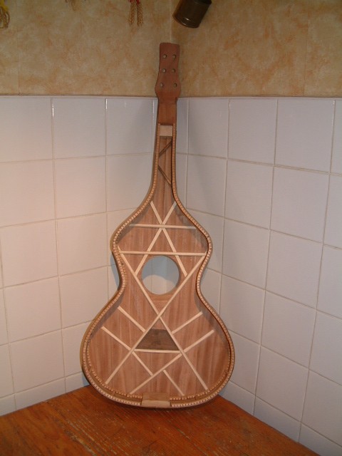

No. I used a lattice of carbon fibre in the hollow neck before the top was glued on. Plus as the top under the fretboard wasn't long enough I put a spruce brace in where the top stopped and an extra top piece was glued on to reach the headstock:
[QUOTE]
- What changes to original neck/body join construction techniques did you make, and why?
Lots I suspect - because I do my own thang y'all I don't know what Herman did. I took my idea from Christophe Grellier.

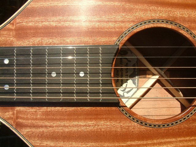

What do you guys use for fret markers? I have some 20/20/20 BWB purfling which fits perfectly in the kerf of my 7 1/4" Diablo blade. They look great in the Jatoba fretboard & show up well, even in low light situations.

On the first one I used some rope purfling I had spare:
On Martha's I used bwbwb purfling I had spare. I set up a jig for my laminate trimmer and found a router bit that worked in each case. On the next one I'm doing (a double neck) I will either use the rope purfling or some birdsfoot purfling.
On the fretboard I actually took the opposite view and thought of it as a brace to help stiffen the hollow neck/soundhole area. I think it was around 8mm thick.
