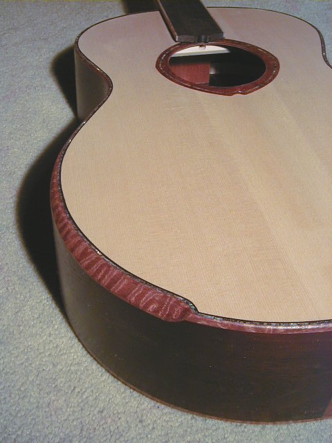

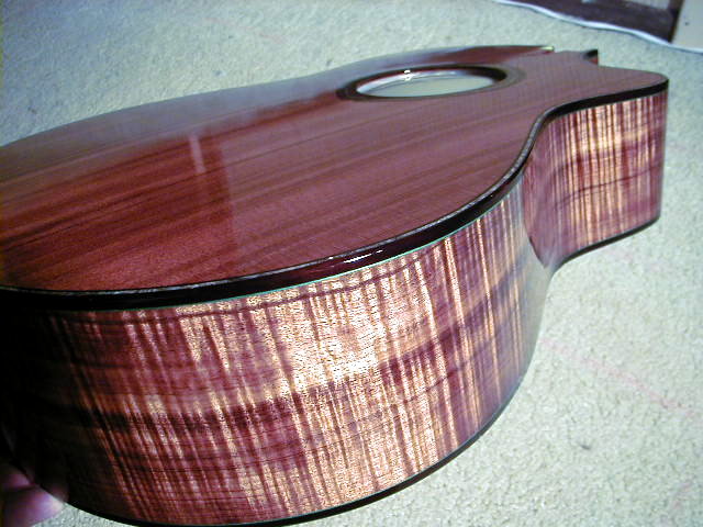

Lance heres the full shot of the bevel and a taz fine art redwood topped guitar. lance

Those are really nice Lance, especially the arm rest.

Very nice! That bevel blends so nicely....well done.

Okay, this shot makes the Sapele stand out on that bevel.
The Tazmanian / Redwood combo is absolutely outstanding.

Lance those guitars look sensational. I'm a novice in the guitar building world but I dream about creating great sounding guitars that are easy to play. I have never played a guitar with a bevel but I have 2 instruments with 5 inch deep lower bouts and I think they would be much more comfortable to play with something similar to what you have shown above. How much extra work is involved? I don't plan to attempt it for some time but just strikes me as too practical to ignore.

I really like the rosettes, which in my mind are a trademark of your guitars. Great looking combo with the Tassy Blackwood and redwood. I'll have to try that combo, having an abundance of both.

The Redwood guitar is sweet!

Nice Lance...I like your more subtle armrest. And I'll bet it's every bit as effective as a more prominent flange.

   Could you explain how that piece of binding that morphs into the bevel armrest is cut. I am assuming that it is twisted over in the area where the bevel begins and it must be left tall in that area to boot. I am wondering how all those compound surfaces are compatable. Toss a few suggestions our way.

I really enjoy it when such a fine builder posts his guitars here!Thanks Lance .The bevel is very beautiful and practical.I've never played a guitar with one either but it does look like it would be very comfortable.That spruce top is very nice too. Is it Lutz? I noticed tight grain all accross-reminds me of some Lutz tops I have.

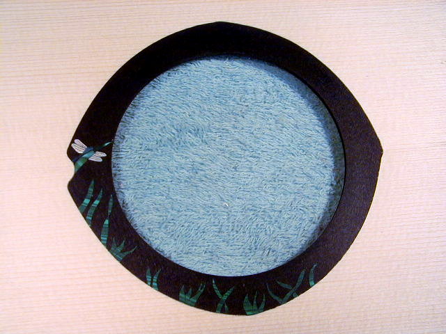

I'd like a closeup of the rosettes!

John K - The bevel binding is a seperate piece than the regular binding. The reason it blends so well is because of the figure. You technically couldn't do the piece with all those compound angles. I have another couple of bevels to do like this in the upcoming weeks. I will try to take some pictures so that you can understand what is involved in the rest of the process. It's not for the beginner. Especially because you have to route the purfling channel by hand because it is like doing an inlay. There are no reference points to run a bearing off of. So if you haven't built a whole bunch of guitars, I wouldn't suggest attempting a bevel yet.
Dave - the top is Carpathian or Croation depending upon who you bought it from.
Steve - The rosette is one of my new designs. It took a lot of brain work to be able to do this with consistency. It still hurts when I get ready to do it. Here are a couple more pictures. It's a new look for me.

Thanks, Lance. That seems like a new look for anybody. Very original, quite attractive. I especially like the dragonfly. Wow! And the little "hiccup" in the pearl that mirrors the end of your fingerboard is a nice touch.
That looks HARD to do....

That rosette is really nice Lance.
Looking forward to pics on the armrest btw.

   I have made about four of the Laskin bevels which I think in many ways is simpler. At least the bottom of the bevel is level and you can run the binding channel cutter at a lower depth and cut everything but the ends. The ends are cut by hand and I don't see any way around that given my equipment.
