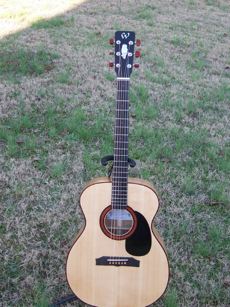

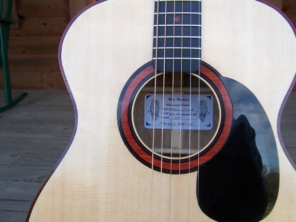

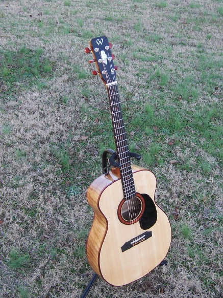

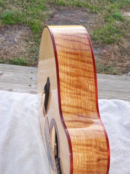

Well, all I've built until now have been dreads. This is my first attempt at an OM and I must say that I love it!!! It was fun to build and I can't describe the sound very well. It sounds amazing to me!! Right after stringing up it sounds richer than my dreads. This is the OM in Kinkead's book.
All the wood in this baby came from UNCLE BOB. Thanks Mr. Zoot!!

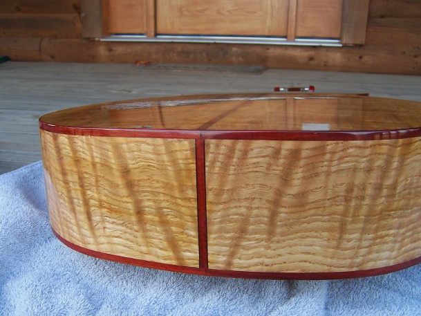

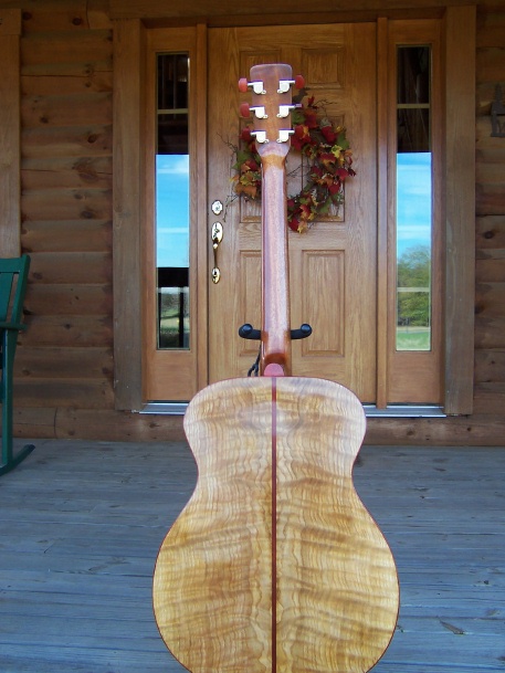

B/S Curly white oak
Top Lutz
All trim and rosette are in bloodwood/ebony. Purfling is
    bloodwood/black fiber.

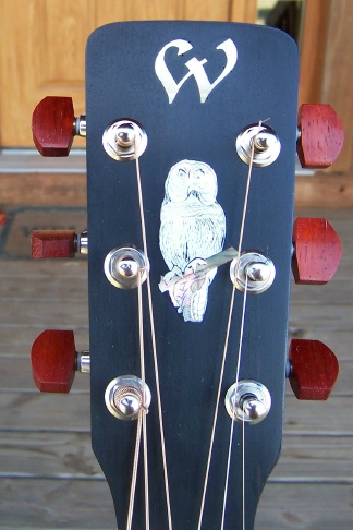

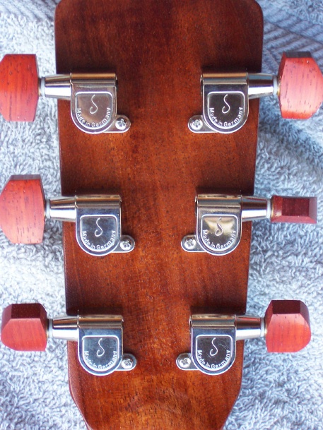

Schaller tuners with custom bloodwood buttons.
Bridge, headplate, FB are ebony.
Pins are boxwood.
This guitar is a gift for my younger brother whose own guitar was ruined in a fire (lightning strike) two years ago. It is a surprise and I doubt that I can wait till Christmas to give it to him.
Thanks for looking,

Fantastic Ron! I love the look of that curly oak with all the other appointments
Do tell, what finish did you use on the body and the neck?
PostPosted: Wed Nov 28, 2007 10:14 am
Thanks, Anthony

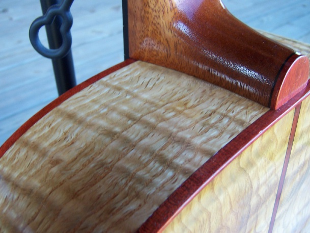

Nothing but tru-oil on the neck.
Body was filled with z-poxy (also a first for me), coat of shellac, then 6 coats of tru-oil.

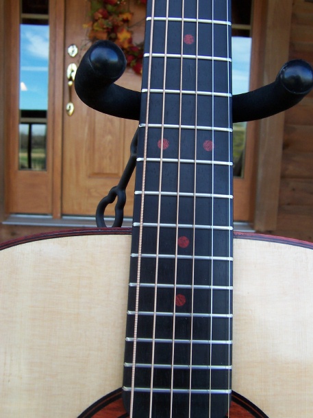

Ron beautiful guitar. i'm glad you posted. I'm planning a curly white oak OM model too. I bought the oak from RC tonewoods a year ago. I wasn't sure if the oak would look good on a guitar and now I see that it can. I am planning on ebony bindng and trim on mine.

Thanks, guys. Much appreciated. I'm not much of a photographer with my little cheapo point and shoot. The color looks different in different shots, but it's a very nice warm brown overall. I didn't want to stain it, but I did use garnet shellac instead of clear.

I'm curious about the Tru Oil finish. Did you buff out the body? If you did buff, how long did you let it cure? I've used it on necks and really like the results. I let it cure for a few days and then lightly polish with 0000 steel wool, but I've never used it on a body.

Absolutely gorgeous!  I really love those bloodwood fingerboard markers.  I gotta stash that one away for future use!  Your brother is a very lucky man!

Thank you, Bob. I let it sit for 4 days, I think, then I very lighty used 0000 wool, then hand rubbed with medium and then fine rubbing coumpound.

As I scrolled through the photos, i kept trying to figure out what the back and sides were, and has settled on some sort of ash, then I read what it was.
Oak?
I've seen a lot of oak in my day, but that is some pretty different, and nice, oak.
