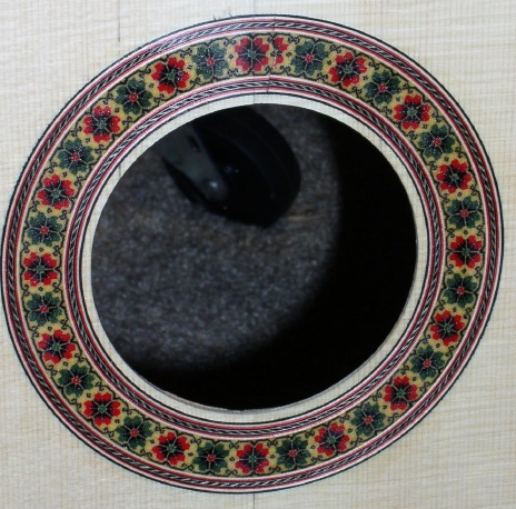

Closeup of the rosette.

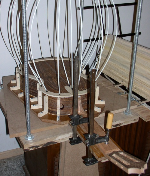

Right now the back is going on.
Thanks for looking.

Quite elegant.
I love that rosette!

Beautiful guitar and craftsmanship Max my friend!!!!  Very impressive and you will get one more clapping hand when we see pics of the completed guitar.
I see what you mean about the light weight bracing - wow.

Yeah, Hesh. Making a flamenco guitar reminds me of making a model airplane. Remember the old balsa and tissue paper ones?
