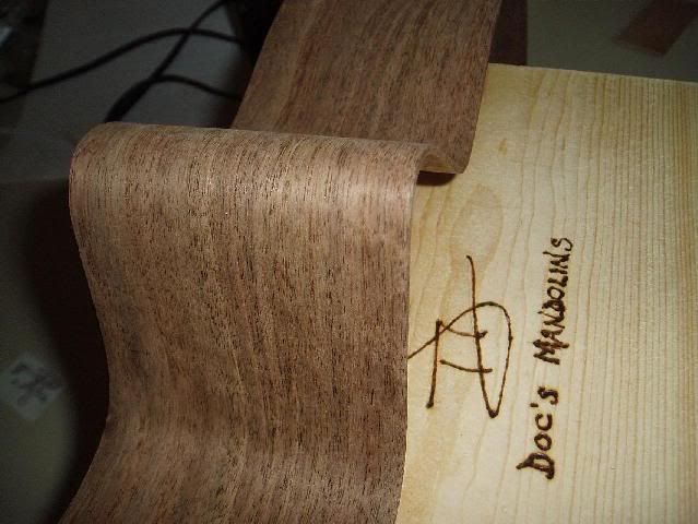

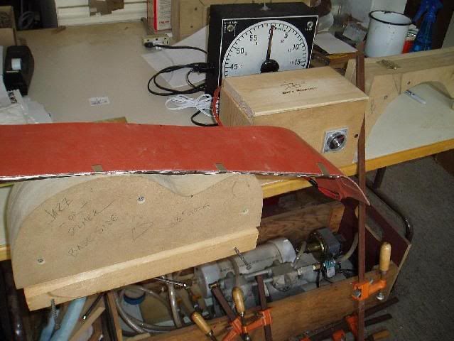

OK>>>here is a rendition of my "Proof is in the pudding" pictorial...I debated pasting the image here, did not want to eat bandwidth if that is an issue...but here they are:
The system......
solid form...waiting for action....
Making a sandwich....here's the ingredients....
Wrap nicely....
Shimstock on both sides...mark any index points...
Cover with blanket....
I use a poor man's approach....hand pressure (with welding gloves!) and then simple bar clamps. Bring the waist in, then over the humps....
With this system, heat is immediate, constant,and even over entire side.
I use cycles of heat/cool/heat/cool ....the results are nothing short of amazing. Your forms better be right....the side will be an exact copy!
That was the easy side....NOW for the CUTOUT!!!!!!
How's THAT for pretty? Talk about tight curves.....I just LOVE tight curves!
A close view....look ma, no cracks!
Just to show nothing's up my sleeve......it really IS tight! This is a mando.....no guitar sized cutaway....
And to close this essay....pudding is served!!!....

If you have arranged accurate external temp sensing, you are in the same ballpark. The beauty of this is the embedded thermocouple....that and the electronic temp controller allow for convenient, ACCURATE temp control. You want to use 305F....dial it in.....need a bit more for a different wood?....dial in 330F....EASY!
The time control?....well, truly if one can watch a clock for the cycles, the result is the same. The timer with controlled outlet simply insures you don't inadvertantly cook a side!.
I do the same; I have a line marked on my blanket's reostat. Need more temp, move it past the line. Need less, move it under the line.
