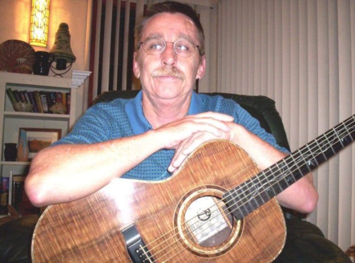

Brock I built several Kao toped IRW back and side OM's. Typical top thickness .100 I braced a bit lighter than I would with spruce.
The tone is more mid tone dominate so you may need to stiffen the bass side.
Koa makes a great finger style guitar with nice bass punch but the highs are not likely to be as bright as you are accustom. They are still there but the dominate mid tone tends to blend chords in to a warm melodic tone for lack of a better term. Curly tops may need filling, or the top will require more finish than you want.
I like IRW sides with Koa top. The IRW seems to brighten the tone a bit. Curly Maple bindings make this combo pop.

Michael--that's a real fine looking guitar! Who's the guy holding it?
P.S.-- Michael makes a good point about the filling. I was concerned about what one maker calls the "Grand Canyon pores of Koa", so I opted to fill w/ shellac, which I thought should be a bit lighter than regular pore filler. Did that work? File it under the recent debate over bridge plates.Steve Kinnaird38559.5868634259

[QUOTE=Steve Kinnaird]
QUOTE]
That be my ugly mug
I filled one with shellac, one with zpoxy and one with egg whites. I like the zpoxy for the ease the best.
The top on mine..seen holding here, is very curly..too curly. The space between curls are so close and tight I think it is a bit overboard. However I have myself to blame. I got the top from Steve at Colonial and told him I wanted the curlest set he had..Well I got it. If I had it to do over I would gone with less curl

PostPosted: Tue Jul 26, 2005 8:51 am
It may be a bit much on my eyes, but is sure sweet to my ears and it has a 14"r. FB to aid my arthritic hands. (the reason I gave up performing)...So I think I will keep it a while longer It is my favorite mid body to play It may be my favorite to play period.
