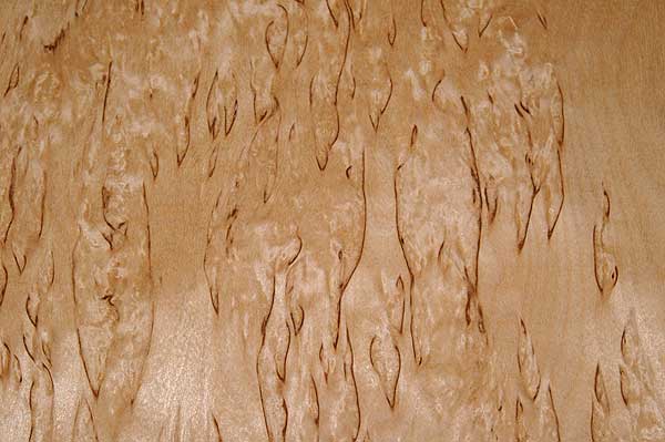

Is anyone on OLF familiar with Brazilian Birdseye ? It's very unique compared to North American. It has a distinctive design not found in the NA variety. It is very hard to get and I am working on buying some blocks. Just wanted to know if any of you would be interested.

Loks like Masur (Karlian) Birch...

What Dennis said. Genus and species?Howard Klepper38560.1249305556

It will be back / side sets. I'm not sure of the Genus and species yet. I just found this yesterday and need to do a little more research to find the correct translations from the Brazilians common names. That's what makes things a little difficult here. They have many different names for these woods. Depends on the area you are and the area it comes from. I just know when I find something somewhat unique, that catches my fance and then have to investigate a little. Just wanted to know if anyone else liked the look and if it's suitable for guitars I'll acquire enought to give it a test. Should know more on the price today. I know it's difficult to find here and even harder to get someone to sell a little of it. It mostly gets used for lamination. But, as soon as I know more I will post it here.

North American Bird's Eye Maple is not used very much in acoustic guitar construction, so you may not see much interest for the Brazilian BE. But, you may find a bigger audience for the wood in solid body (electric guitar) luthiers.

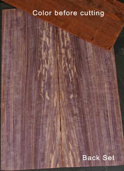

I have found a couple of lesser tried varieties that I am working on. One is Angico Preto (angico-preto ou arapiraca (Piptadenia macrocarpa). I bought one piece to cut and test the tonal qualities. It's very hard and taps out somewhere between Indian Rosewood and Brazilian Rosewood. The tone is sharp and brittle more like Brazilian and seems to be a bit harder. When fresh cut, it's more of a brownish color but, when I bought the piece it was very red. And when you put Naptha to it, it turns a very reddish like the reds you find in BR. This particular board has some markings like a flame. It reminds me of the flames on the "Original" Street Survivors album cover. And as a matter of fact I would consider making a deal with someone on this forum If someone has the desire to try something new...I would let one set go for $30 + the shipping ($35 Priority 5-9 days). Which would total $65. But, I prefer someone who has the desire to start the project fairly soon to get some feedback on the workability. Because there are a few more pieces from the same lot and if things are O.K. (some positive feedback)I would go ahead and buy the rest. I really like the tone tap and think it will build an excellent instrument. It's quarter sawn and the set is cut from the same piece. The dimensions are: Back: 22.25" Length X 7.5" Width X 3/16" thick. Sides: 32" Length and will be cut to whatever width you need also, 3/16" thickness. Anyone game ?

It looks very interesting, and if it has a ringing tap tone, it could be a winner. If the purplish color is correct, it looks like EI Rosewood crossed with Goncalo Alves! Very nice.

USDA info (data looks promising, other than the difficulty in drying it.)
USDA info
I wish I was a prolific builder, I would take the offer. But, I am the world's slowest pre-luthier. I hope someone here gets it and gives it a try.

I think the Angico Preto is more often sold in North America as Curupay.
That may be the common name in Bolivia.
Do you ever get any Brauna (melanoxylon brauna)? I have one set that I
