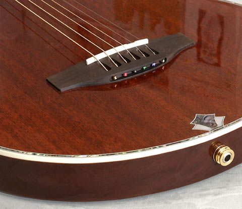

I'm very interested in using pin-less bridges on my E2 models. That in my opinion is my most "Contemporary" styled guitar. I have seen the type were the string ball is anchored to a post, i.e. Mike Doolin, and I have seen were the strings slide into a hole and out to top of the bridge, I believe David Berkowitz is this way. My favorite style is a routed channel that allows the ball ends to sink into the bridge and then the strings pop up out of the top, just south of the saddle - Mike Baranik comes to mind.
Anyways, what are some of the pit falls of NOT having a post to anchor too? I'd fear the top of the bridge would get ripped off.
LanceK

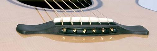

Lance,
I've built only one steel string guitar to date, and I fabricated a simple pinless bridge for it. You can't see them in the photo below, but I actually inserted pieces of brass tubing in each of the holes to preven the ball ends from digging into the bridge. I like the looks of the recessed area for the ball ends better though.
The reason why I installed a pinless bridge on this guitar was because I honestly did not feel like hassling with drilling the holes in the top and then doing all the reaming and fitting for the pins.
Yup, I was just being lazy.
Still, the way I saw it was this -- if the glue joint is a good, solid, clean joint, it will be stronger than the wood that it's joining. So I wasn't all that concerned about the prospects of having the bridge pull up. Welp, we'll see how right or wrong I was in a few years, maybe more.

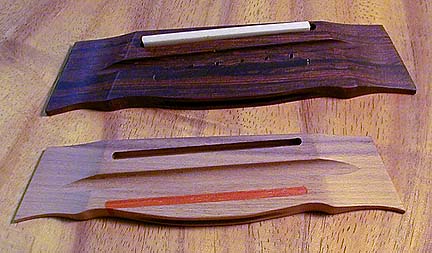

I've done a few of them, and I plan to use some more. Here's how I made the ones I have used so far. I routed an extra slot while it was on the saddle slotting jig and glued a piece of wood in there, which ends up being across the top part where the strings come through. The idea was to provide some cross-grain in that area for some extra strength. There are two bridges in this pic- I made one out of walnut with a padauk insert, so you can see what I mean, while the rosewood one has an ebony piece in there.
