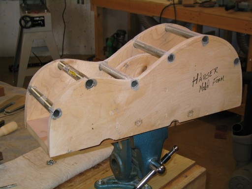

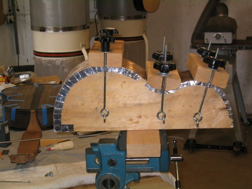

I was at Kent's shop last week and we were talking about the bending forms. His old forms look like the photo with the silver HVAC tape on the bending surface. His new form looks like the form with the pipes for the center section. He still uses I-Bolts and the wood blocks like you see in the photo.[IMG]useruploads/BarryDudley/2005-08-Barry Dudley38587.644212963

The 2nd pic is what I saw at ASIA, but Kent said that LMI had modified his version by putting 2 clamps on both bouts that were held by springs. The middle clamp basically looked like the 1st picture.

I might add that the "new improved" form shown above looks almost identical to what John Hall sells, and one of those in your choice of pattern comes with John's bender. I have one of John's units and it's a very professionally made tool.

Kent even removes the pipes when not in use to make the forms easier to store. I glue my pipe in with JB Weld. That was John Kinniard's idea and it work great
Kent also has one with a threaded screw rod for the waistlike a fox bender without the whole frame. Barry Dudley38588.587337963
