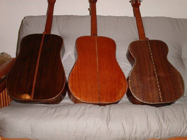

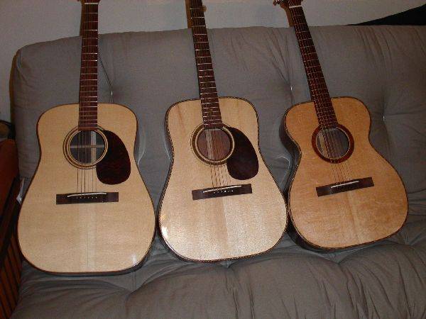

After almost 2 years numerous setbacks, problems and disasters, I have finally finished the 3 guitars I have been working on. The photos are so bad, I'm almost ashamed to post them, but here goes anyway.
They are:
Dred - Engleman/EIR
Dred - Ad/Mahogany
OM - Sitka Bearclaw/Walnut
Backs

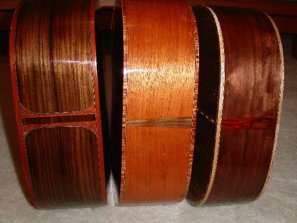

End View

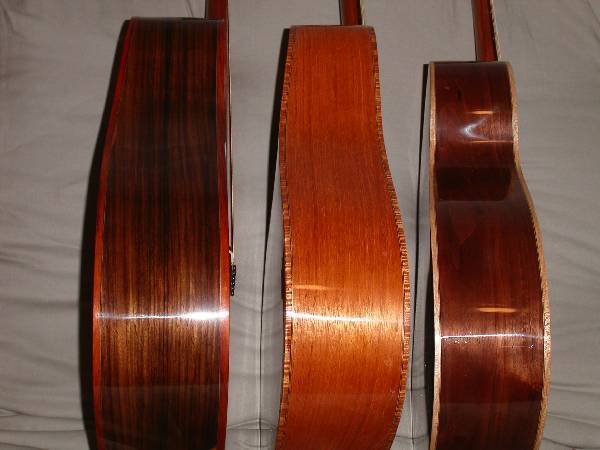

Side View

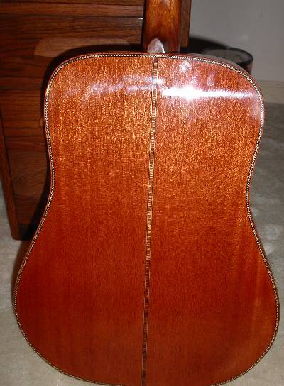

Mahogany Back

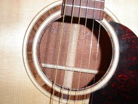

Rosette

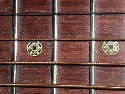

Different Take on Fretboard Markers

Great work! And I really like the position markers.

Ill second that! The position markers are killer!

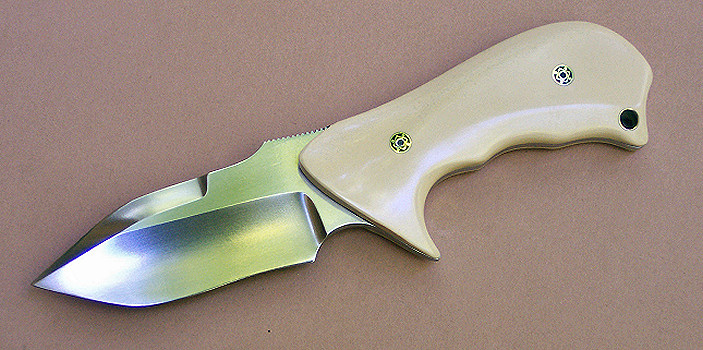

Very nice looking guitars there. Your fretboard markers are the same as the pin stock I use in my knife handles. I'd thought about doing that on my guitars, but now that you have, I won't.

Jimmie, nice work! Good to see you out from under the pile and all 3 finished! I too really like the position markers...how thick are they? Are they metal or wood? I like the bound soundhole and wood rosette too!

Very Nice Jimmie
Love the Tail piece on the EIR one.

Great work! Very nice, you should be proud of them. What kind of finish did you use?

Jerry, Cool knife too. I checked out your site. You are doing some great work. :-)

Thanks everyone for the comments. I have taken them to a couple of jams and have gotten very favorable comments on the sound. The sound from the OM really surprises people. My instructor AB'd the OM with his D28 and the Om was louder and had a more even tone. Now he wants me to make him one.
Jeff, I used Behlen's Instrument laquer. I liked it pretty well.
Jerry, I knew you would catch the postition markers. I used to fool around with knifemaking a little. A guy at he Knifemakers Guild show in Kansas City about 23 years ago showed me how to make those. It's really not that hard and the designs you can make are limited only by you imagination.
Larry, the dots are about the same thickness as MOP and they're just brass tubing and colored epoxy. I put just a tiny drop of lacquer on them with a toothpick to keep them from oxidizing.

This might be an easier way to make them...
Texas Knifemakers Supply
Look under Mosaic Pins.
I tried making my own once. That was the most expensive $25 I ever saved!
