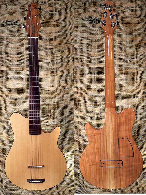

Here are a few pics of an electric/acoustic guitar that I built. It has a piezo pickup in it, and a preamp that I built as well. A while back, I built a "mezzaluna" bass that was designed by R.M.Mottola (you can easily find his website, he's a GAL contributor and there are lots of nice plans there) and I liked it a lot. it had some interesting design features. After I built that bass, I thought it would be great to have a guitar with these same ideas....so here it is.
The bridge houses the piezo pickup. The bridge sits in a pocket in the top, and it rides on two set screws that you can access from the two holes in the back. That way you can easily adjust the action! The door for the controls is magnetic, the battery is under there. It's very light, being mostly hollow. There is one fairly stout brace directly under the bridge that has two screw inserts for the set screws, and I used a spruce top that was too small for anything else...I am really surprised at how loud it is acoustically! And plugged in, it really works well. Other than the spruce top, the rest of the guitar is cherry.
Mark Swanson
Swanson Guitars
PostPosted: Mon Sep 12, 2005 12:25 pm
Posts: 575
By the way, these pics are Steve Kinnards' fault. His cool telecaster inspired me to take these.
Here's a shot of the back, you can see the door and the cover plate with the holes a bit better. I love cherry!

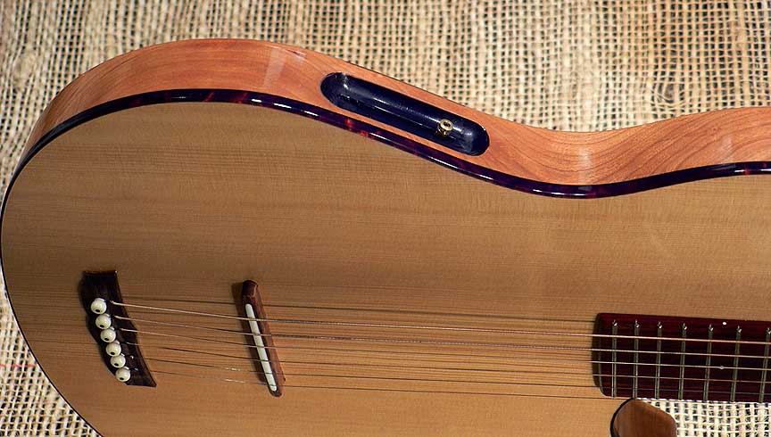

Here's the front...you can see the slider for volume, and the knob I made from a bass string ball.
Since this guitar was built for me, and a bit of an experiment I used whatever wood I had, and you can see some flaws and small knots in the cherry. I don't care. Mark Swanson38607.8948263889

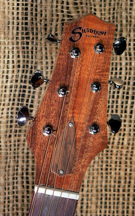

And the peghead...
By the way, all I have is the volume control on this guitar and I like the way it's side-mounted and not in the top. There is no need for me to ever use a tone control, I don't need 'em!
Mark Swanson38607.8971064815

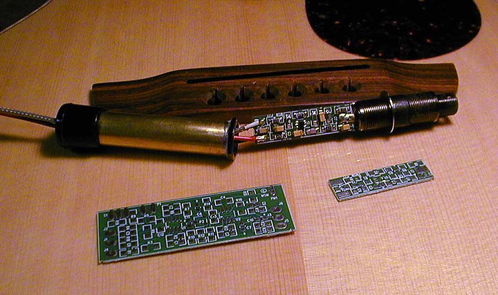

Thanks...no pics of the inside, or sound clips, sorry. And yes, that's a waterslide decal. it shows a faint "ghost". If I had hit it at first with a little bit heavier lacquer coat it would have melted that in and it wouldn't show- but it's a fine line! Too much finish and it'll melt the whole thing and blur it.
I really have an interest in guitar electronics and have had for years. I make all my own pickups and preamps, I wind the magnetic ones and use piezo wire to make my own under-saddle acoustic pickups. Some of the preamps have two inputs, and can be used with a piezo, a magnetic, or a mic- choose two - and they have a blend control. I can set them up for electric or acoustic guitar. The one in this guitar is a simpler, one pickup system. Sometimes I wish that I had put a magnetic pickup on it too but then it wouldn't have a clean top and I'd need to use nickel wound strings and it wouldn't have as good of an acoustic sound.
Here's a picture of a couple of the preamps, and this one is set up to fit on the endpin jack in an acoustic guitar. The one soldered onto the jack is loaded with all of the teeny components, and the other two are PC boards ready for the components. I need to use a magnifying visor to solder those things up!
Mark Swanson38608.0122569444
