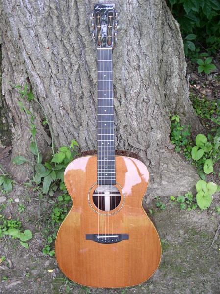

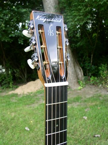

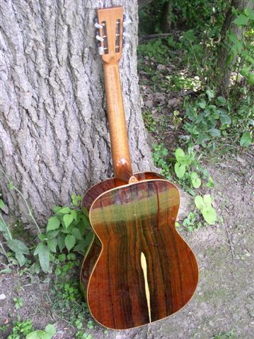

PostPosted: Tue Sep 20, 2005 11:07 pm
Speaking of 14 fret slothead
PostPosted: Tue Sep 20, 2005 11:33 pm
Lance
That guitar tree you got there is something else, it produces some very nice fruit
PostPosted: Wed Sep 21, 2005 3:09 am
Posts: 952
Whooeee
and a fine looking slot head it is too. The exception that proves the rule.
Is that your own, or a recently finished instrument?
PostPosted: Wed Sep 21, 2005 3:14 am
Kinda a pain to change strings often but they sure look cool. On my next build I'm thinking of doing one where the slots converge towards the top end of the headstock. Nothing new except for me.
PostPosted: Wed Sep 21, 2005 3:15 am
[QUOTE=John Kinnaird] Whooeee
Is that your own, or a recently finished instrument?[/QUOTE]
Thanks John - That is a guitar that now lives in Santa Barbara CA. A commission.
PostPosted: Wed Sep 21, 2005 3:21 am
Here is a nice one by Gary Zimnicki from Michigan
