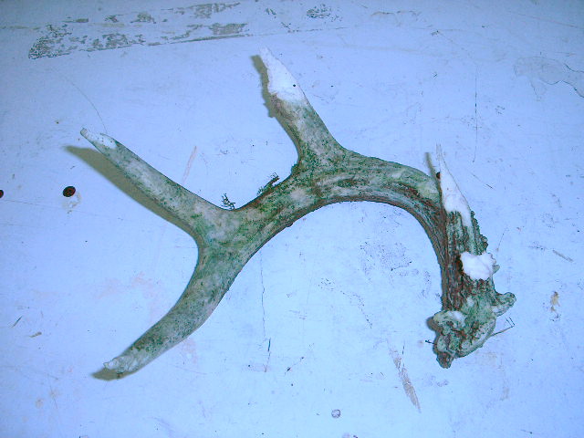

Hey folks, I just got back from a weekend in the BC outdoors and found this lying in the bush.
Have any of you used antler before?
Would I treat it the same as bone? Boil the heck out of it and notify all the neighbours when I cut it.

I am no expert but having made a knife handle from wite tail antler I would think it to porous for nut and saddle material.

I have experimented with Moose antler (I can get truckloads of the stuff) and have found it to soft and porus, muffled the sound.

Rod, you might be able to use it. I would try cutting some-- that should indicate if it is hard enough.
I have a question about boiling it, though.
Is that standard practice? I would think (and mercy, I could be WAY off) that boiling bone--for instance--would drive the fats further into the material?

I think that's a great suggestion Steve, Just give it a try, got nothing to loose.
I will look at it under the magnifyer to see if I can see any difference between cow bone, doubt I can, but hey, why not. Maybe I could build a woodsman guitar, locale woods, with the antler nut and saddle as the feature.

Sure--or just do the "file test".
If it's hard like ivory or bone, you're good to go.

I've used antler for cane handles and I too think it is too porous for nut and saddle. You might fill the pores with CA and make it work.
