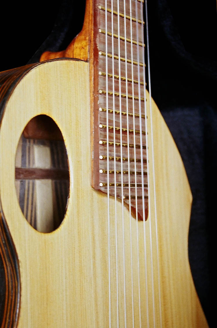

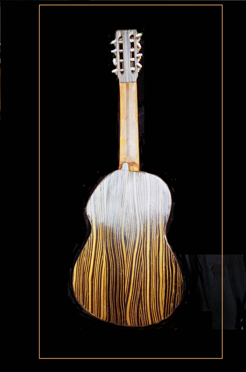

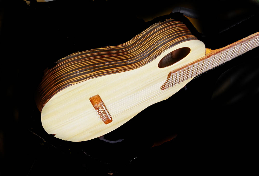

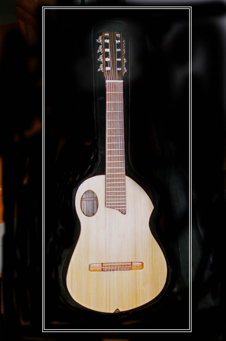

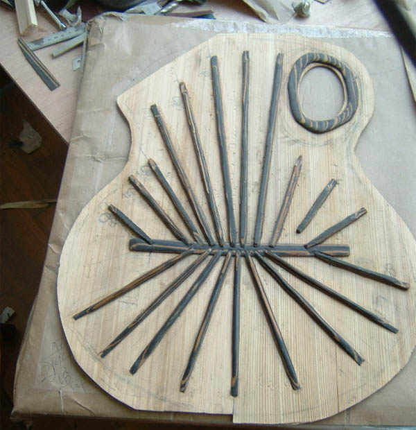

It's not asthetically perfect. there are lots of mistakes but it sounds great. The bass notes have an great sustain and tone. It's much better than the classical I play now. I am happy to play it.
specs
8 strings
top: 4 piece spruce
bracing: striped ebony
Back: 5 piece striped ebony from a wall molding
Neck: huang hua li (yellow rosewood) and ironwood center
Fret board: Ironwood
Bridge: Yellow rosewood
Bridge cap: ironwood
frets: brass welder's bar

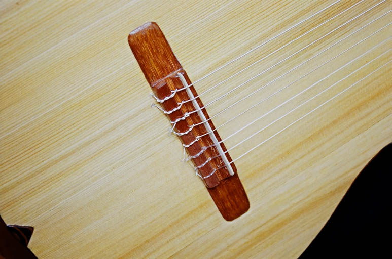

nut and saddle: bone
finish: tung oil and wax
billb38647.0626851852

Hey Bill, I love that guitar!!! The shape is great, the back is beautifull and the top has a ton of character, I just wish those cool braces could be on the outside so they could be seen. That striped ebony is about the best I've seen, it is very bold and you've really done it justice. It looks great with the binding of the same as well. Keep it up and show us some more.

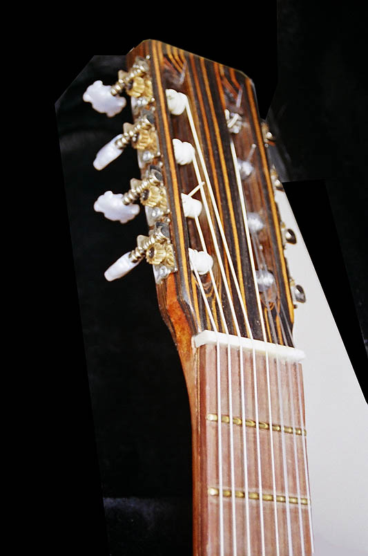

The intonation is off after the 14 fret, so I'll have to move the frets. That's no big deal because they are just super glued on the fingerboard.

How did you make your own fret wire? That's a fairly major accomplishment by itself, and one that is probably beond me unless you tell me how.

The fret wire is brass welders bar. I had a couple options of what I could do with it. First I could shape a tang on it using a jig I made, or I could leave the bottom circular and file a round crevice for it like a Boaz Elkayam design.
I found this to be very time consuming and difficult, so what I did was I filed the bottom flat and just super glued it to the fretboard, and then shaped it. I read about a luthier before that does the same thing with stainless steel frets. I've been playing it for more than a week now and have had no problems. During the shaping I pulled up on a few of the fret ends with the file and they came loose at the end, but it was easy to reglue them. The brass sticks really good.billb38647.9950462963
