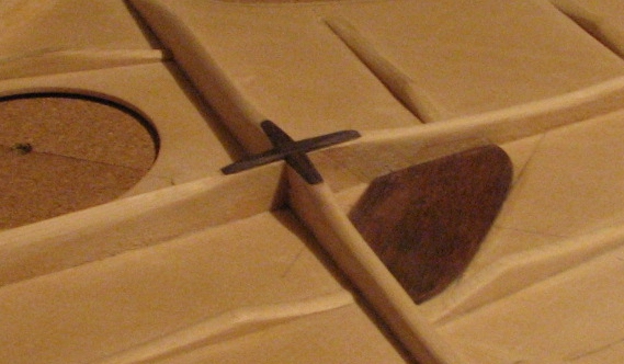

Here's a pic of my x-brace cap.

Hey Larry, I tried to do like Somogyi says. Glue in the braces square, then you add the cap, then shape...

Yeah I get it thanks. I guess a guy could shape braces first leaving a flat spot for a future cap but I really like the way the cap blends in. Nice.

Alain's cap in the picture is (to the best of my knowledge) atypical. Normally it is not an X but a single piece glued across the "open" section of the cross. (across the cut lines). Some folks use a disc of wood which ties the entire X together.
