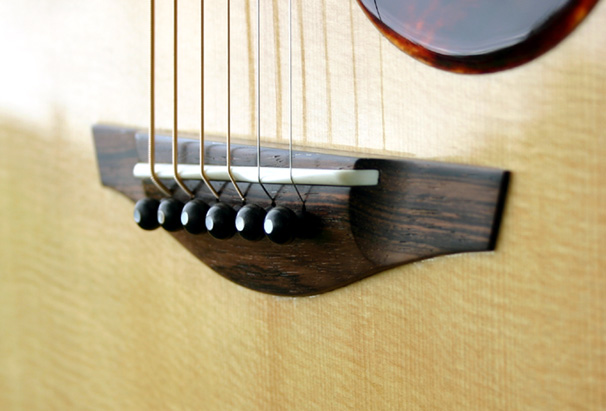

PostPosted: Tue Jan 24, 2006 10:58 pm
I compensate long saddles just like drop in ones. Like this:

The first time i've seen compensated saddles was at Gerald Sheppard's site, and his guitars sounded really good if compensation had any role to play with it.

The 00-18V is 24.9" scale, right? You'll definitely benefit from
compensation, usually the B string is too sharp and the G string might be a
little flat. The saddle needs to look a bit like Arnt's picture. On a longer

Arnt, beautiful bridge and saddle, BTW!! And as Hesh suggested, I like the idea of cutting the slot and the bridge wider - that makes a lot of sense (one of my guitars was made that way).bluesphile38742.7832407407
